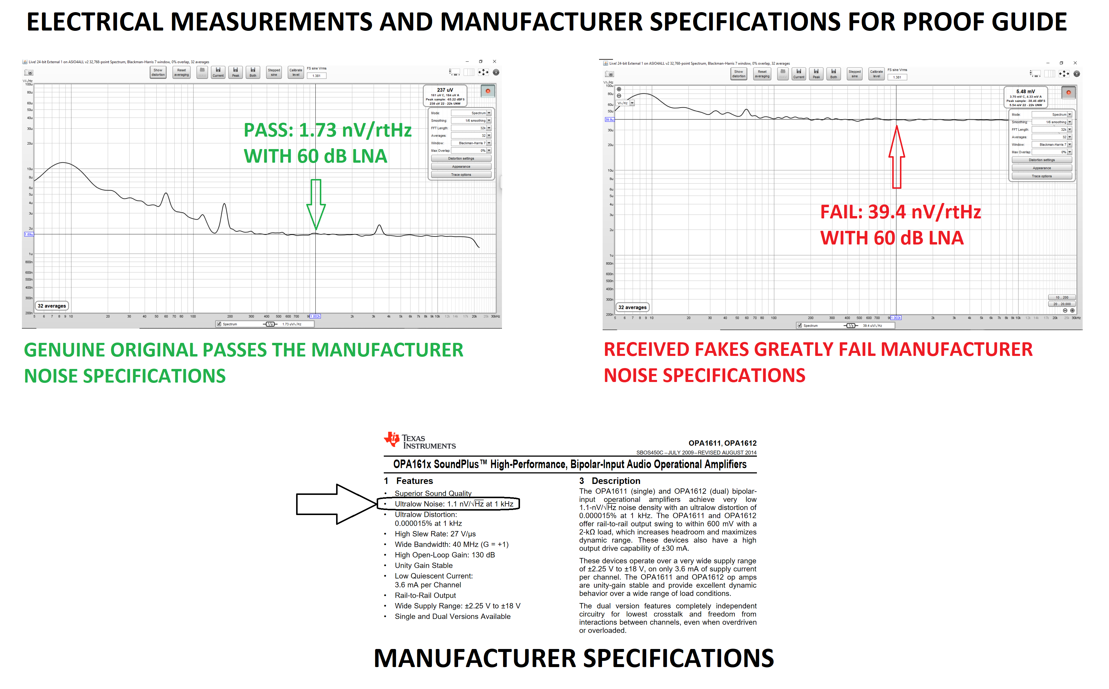

I had received real OPA1612 in a first (small) test order. So I placed another order (for 20 pieces) from the same seller and received fakes that measure 40 nV/rtHz at 1kHz!

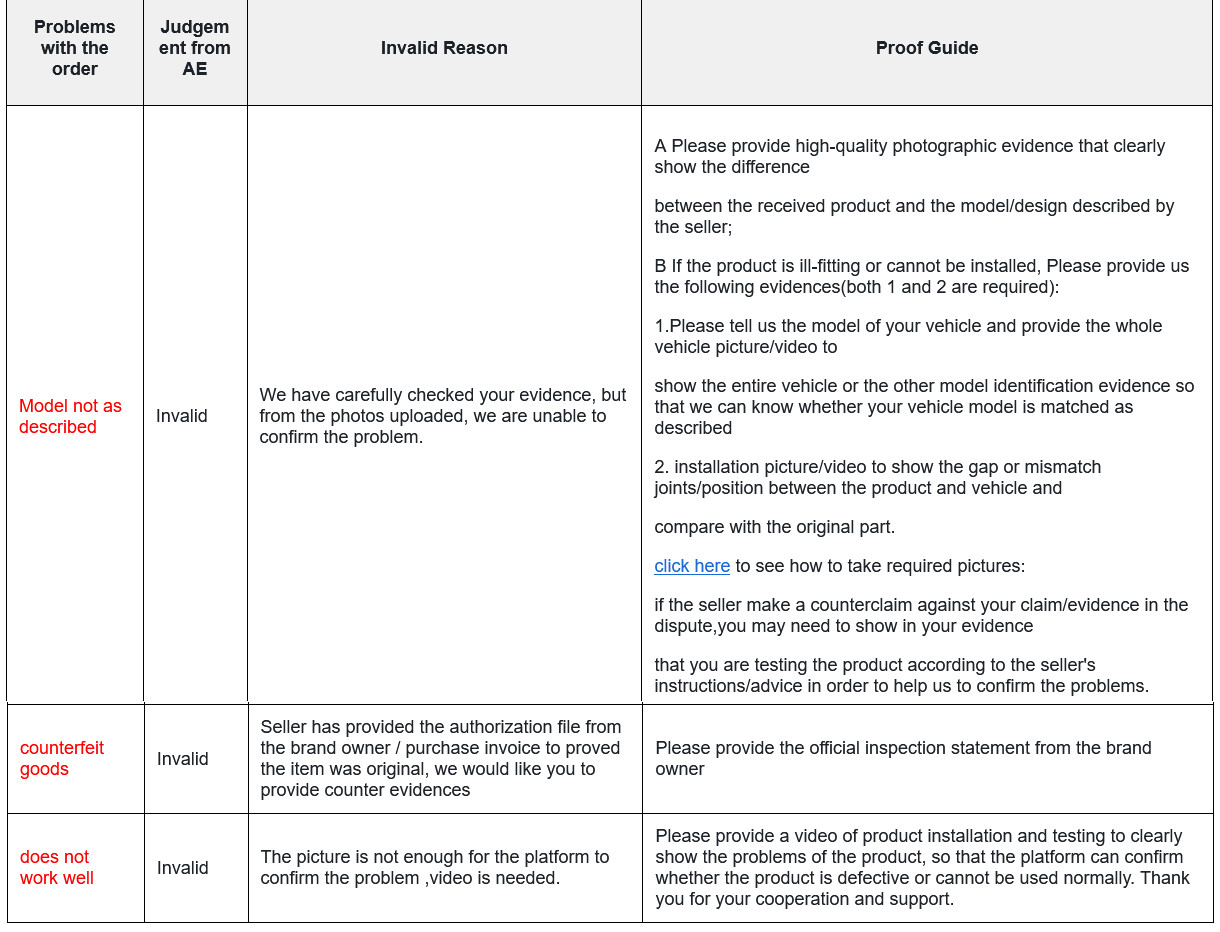

AliExpress rejected the dispute! (Rejection attached.) Has anyone any experience/advice dealing with AliExpress on this?
The attached images are:
1. Dispute Rejection From AliExpress
2a. Noise of Real OPA1612 & LNA (measured w/60 dB LNA consisting of 3|| 2SB737 & OPA228)
2b. Noise of Fake OPA1612 & LNA (measured w/60 dB LNA consisting of 3|| 2SB737 & OPA228)

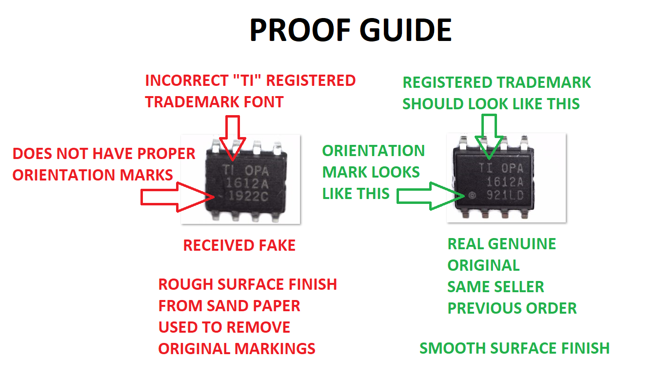

3a. Picture of Fake OPA1612
3b. Picture of Genuine OPA1612

Something I have learnt about Ebay & AliExpress orders... Before I built the LNA and before I built the Hall notch filter (for low level distortion measurements) I thought that many of my AliExpress orders went well.
However now that I can measure the noise and distortion I have discovered that the vast majority of the low distortion/low noise audio op-amps are just remarked 358, 4558, 741 and TL071/72/81/82 series. The problem is severely widespread.
Also measuring the input bias current, input offset voltage and quiescent current detects a reasonable number of fakes.
