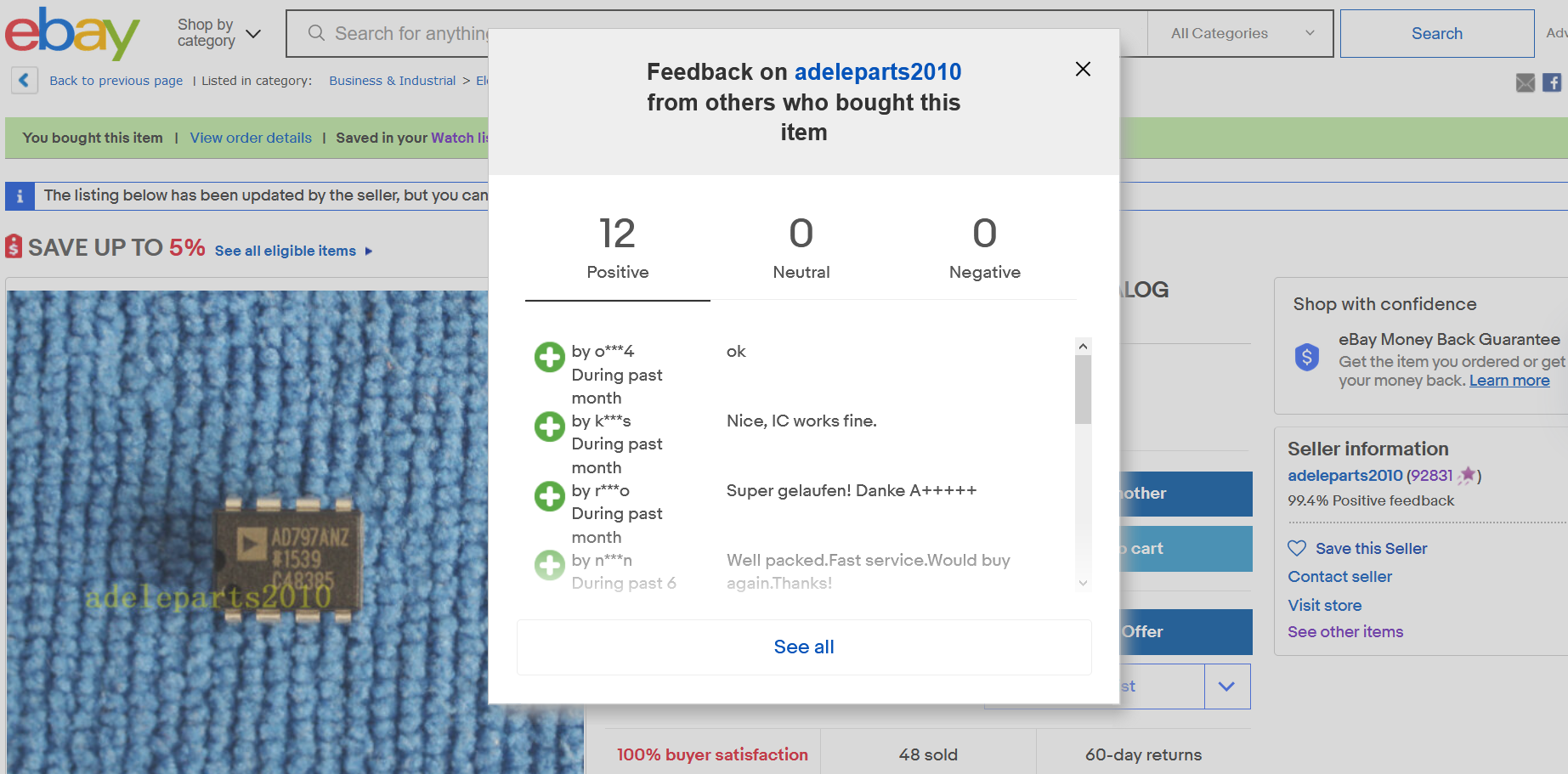

After a couple of days my negative feedback for the fake AD797 has mysteriously disappeared from Ebay. (Seller Adeleparts2010.)
Now we know why there are no negative feedback ratings for these fake AD797. Apparently someone deleted the negative feedback. As far as I know Ebay is the only one who can do that.
I wonder what other online sites delete the negative feedback for fake products?

Are you sure your feedback has disappeared?
That would be an extremely worrying thing if it is true.
Indeed. Even on China's Tmall they do publicly announce that negative reviews won't be allowed - eBay has sunk lower than Tmall as its passing off the reviews as genuine.
A few years back I saw negative reviews disappear on AliExpress for fake IR mosfets. But now it is clear that eBay is doing the same.

There are 75 negative feedbacks on Adelepart's ebay account in the last 12 months, mostly for fake parts.
So not all the negative feedback is being removed.
Yes, but my point is that Adeleparts2010 has sold thousands of these AD797 without a single negative feedback showing for that product. I don't know how many negatives were left and deleted in the past but I do know that the negative I left was deleted.
I would not have gone again my rule (of not buying op-amps on eBay or AliExpress) if I had not seen thousands of AD797 sold by that seller without a single negative review on that product.
So they have sold thousands of "AD797" marked chips (and also thousands of "OPA1612" marked chips) and not a single negative remains for those chips. So sadly it would seem that thousands of DIY audio types have fakes in their DAC and pre-amp projects.
