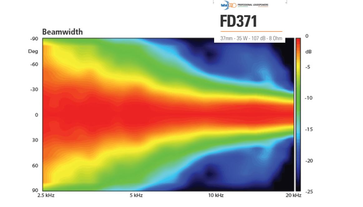

Comments on this Jones-Scanion large format studio monitor...? I can see that there is a 6.5" Purifi midrange driver... Can anyone identify the "bullet" style tweeter? What would be the design goals of this type of arrangement? I haven't seen any studio monitors with this type of HF driver in the last 20 years...
You are right. It has the same mounting holes as the Faital. It can be crossed astonishingly low according to the datasheet. But I wonder why they didn't turn it by 45 degrees such that it could be mounted closer to the Purifi. I generally wonder how competent the design is when all aspects are taken into consideration.

Faital Pro recommends a minimum crossover point of 2.6 KHz (12 dB slope), whereas these guys seem to be crossing over @ 2.25 KHz (possibly with a 24 dB slope)... Makes sense?
40 x 40 dispersion seems much too tight for the nearfield... no? For example, these HR5s from Ocean Way boast about their 100 degree dispersion... They are particularly well known for a very wide listening window...
The woofers are probably better than you think. They seem to be real 10" midwoofers and not just low-going midranges like the average 10 PA driver. But it is still a strange design to me with that low efficiency Purify driver combined with high-efficiency woofers and tweeter. I would also like to see a sonogram of that critter with that midrange/tweeter combo.
The 3-way monitor specifications mention crossover points of 160Hz, 1950Hz and 2250 Hz, which would indicate an "underlap" between the mid-high point, which likely is steeper than 24dB, the DSP using 192K SHARC processing.
With a sensitivity of 107dB 1 watt, one meter, the Faital Pro FD 371 tweeter probably could do over 127dB without exceeding it's power rating or excursion limits crossed steeply at 2.25kHz, probably well over what the 6.5" Purifi midrange driver could achieve.
The Faital Pro FD 371 tweeter has over 40 degree dispersion at 20kHz, unusually wide for a "bullet" tweeter. It's smoothly widening pattern doubles to around 90 degree at 5kHz, expanding to near 180 degrees at 2.25kHz. While I'd agree that a 40 degree VHF pattern is tight for "near field", the Big Reds "cater for the very loud and fat far field monitors commonly used in the wall or on stands in large format studio mixing rooms", but eliminate the horn midrange typically used in many previous generations of large format studio monitors.
