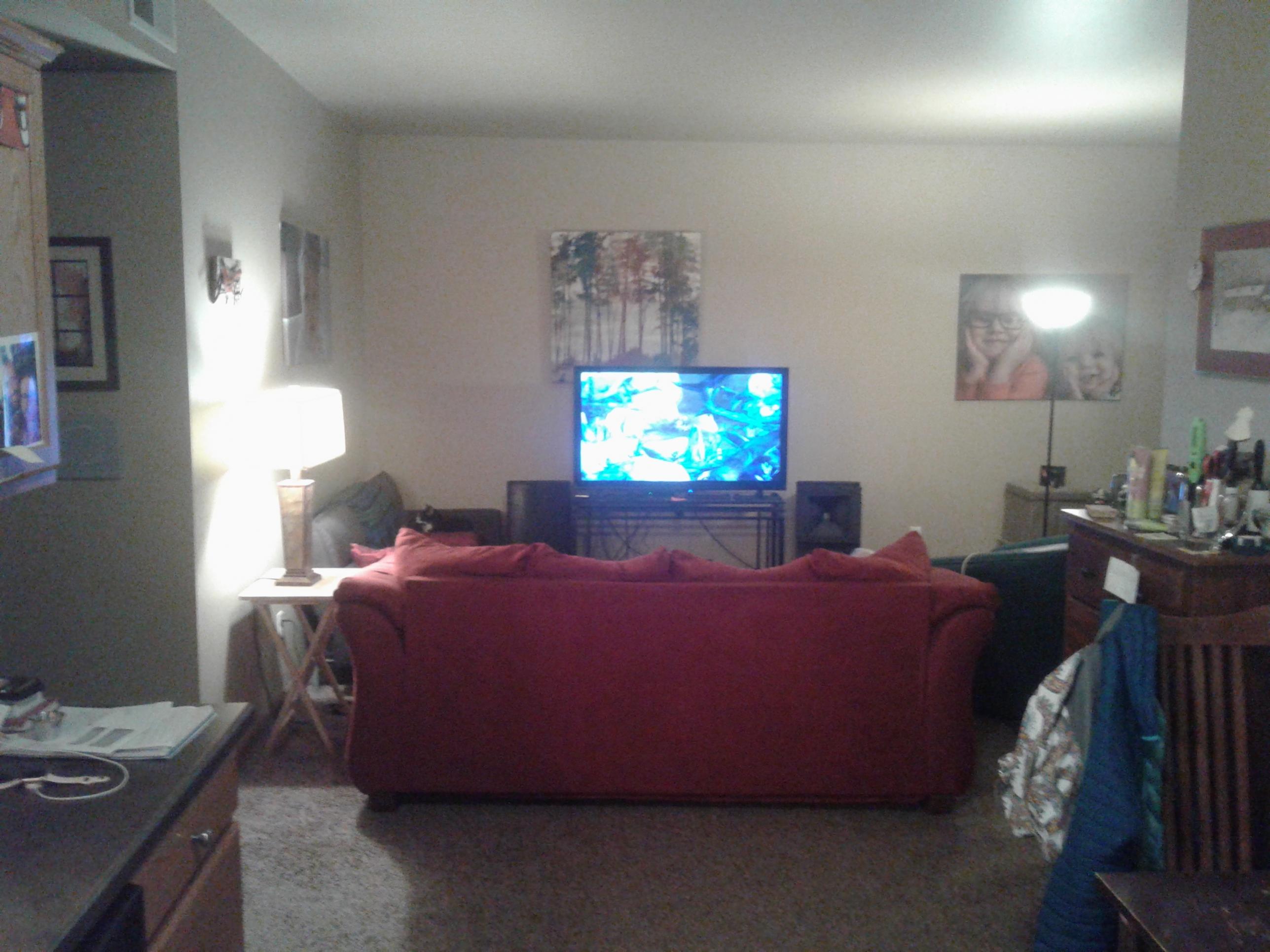

from back in kitchen.
Notice room goes off to right and halway on left.
Have to leave grill on left speaker so visiting sleeping grandkids feet won't poke through woofer.

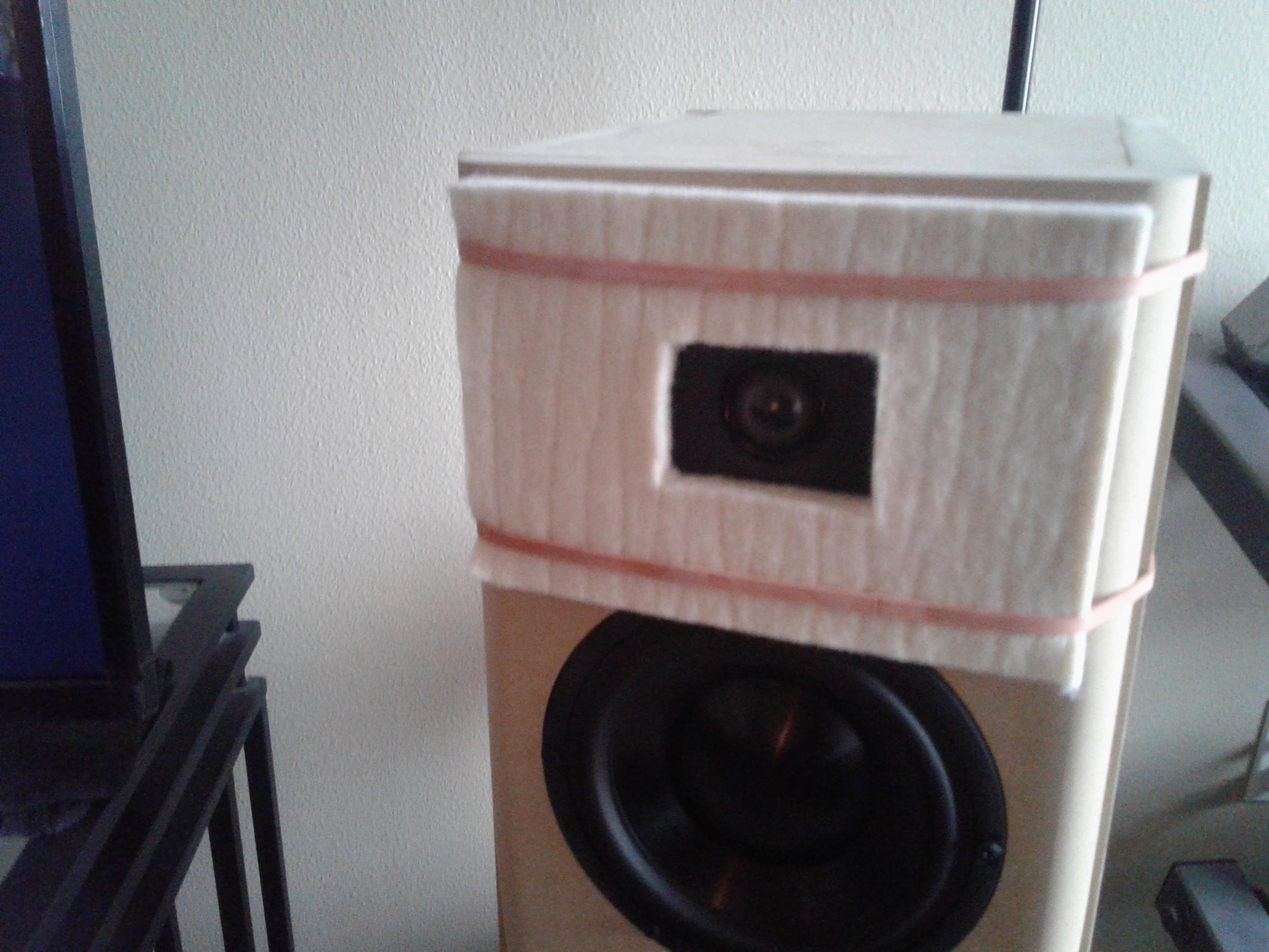

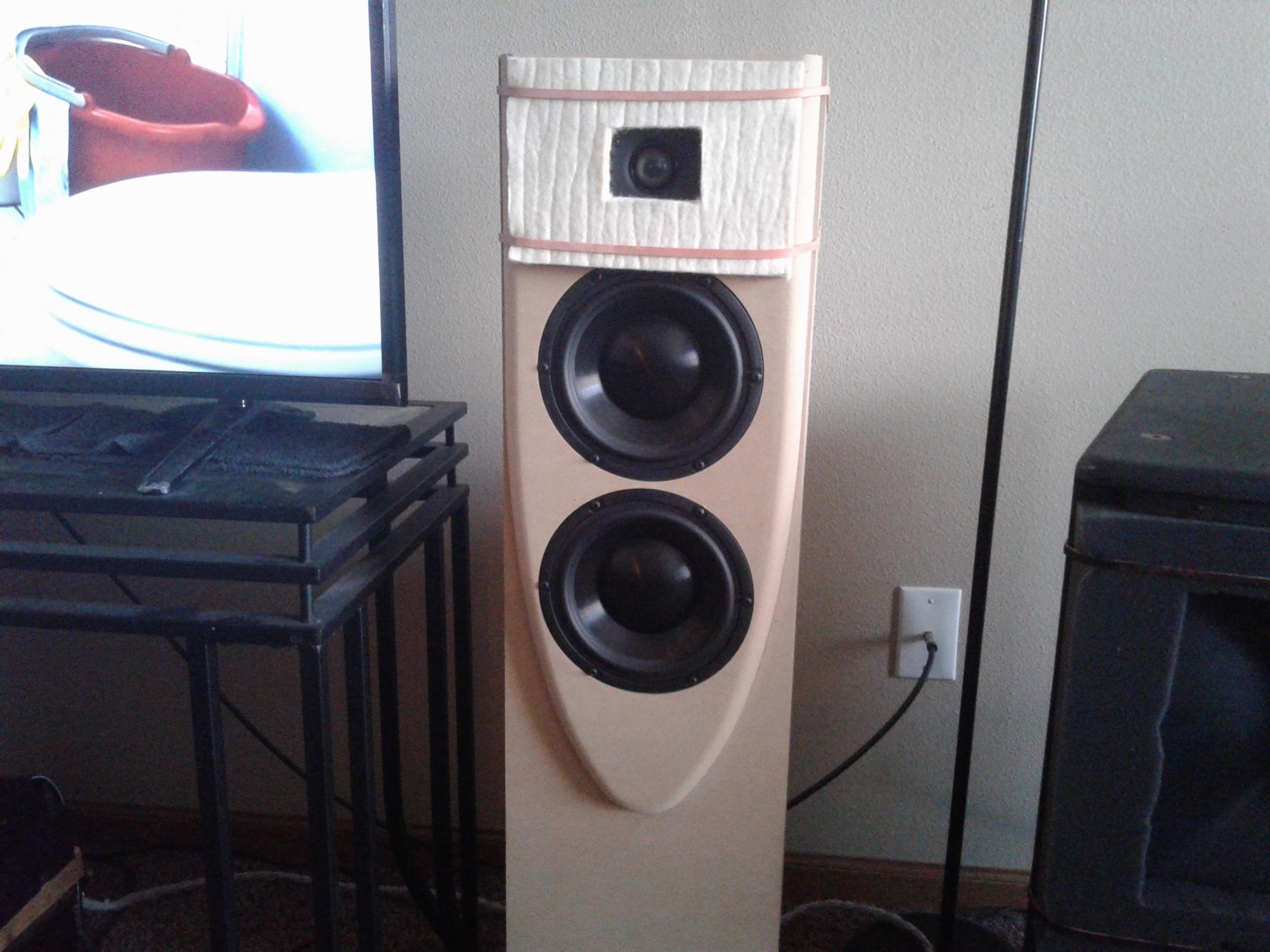

Sorry for the delayed reply, finally got around to grabbing some pics!
