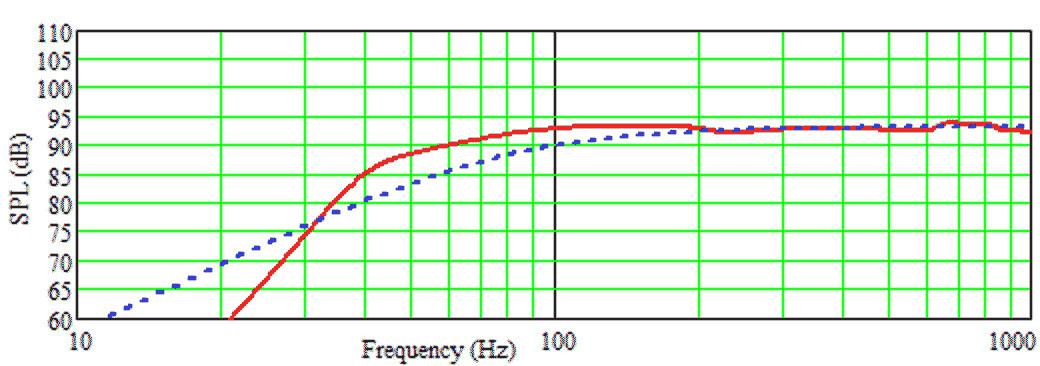

Whatever driver is preferred, in the end, is going to need some serious BSC (and extra efficiency to allow it) with such a narrow baffle.
Would any of the micro sub drivers manage this? Without needing like 4 of them to get the efficiency up?
Though I do have the cheapo Monacor SP60 4" woofers. With a high Qts and Fs in the 80s, I'd imagine a max flat alignment could get F3 down to 60Hz or so.
I suppose theres always some small Jordans that reach low and are small enough.
But isnt that a little bit of a travesty?
I challenge you to find a midrange appropriate for the design, so no more than 3", that exhibits more than 85 dB and stands about 30 W power...

re:'some serious BSC' - that's why I went push-push with the SB13PFCs
re:'no more than 3", that exhibits more than 85 dB and stands about 30 W power.' - used the Vifa TG9,... but it can only handle 10W... hopefully it's crossed over high enough (900Hz) that it can handle some LOUD testing.... yet to do this...
I did buy a couple of Polyswitches just in case, yet to fit them
