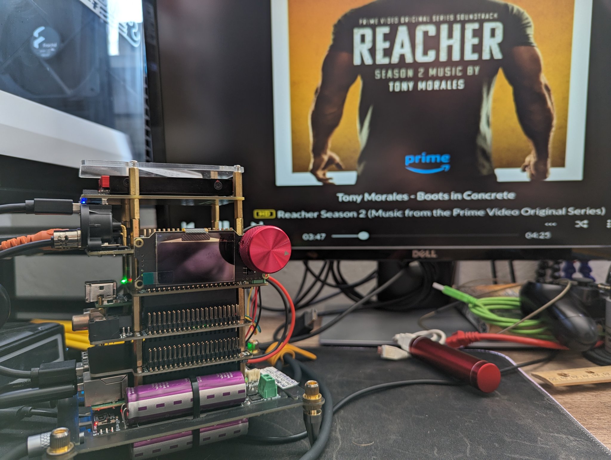

Parts List:
M.2 - 1TB (Type B key)
GeeekPi SSD Storage Expansion Board w/USB 3.1
TransportPi AES
FiFoPi Q7
ReceiverPi DDC
ShieldPi Pro
MonitorPi Pro
Raspberry Pi 4B
PurePi 3.3V/5V
The list above is also my proposed build order. Does it seem correct or should I change the stack? If change is needed, how?
I also would like to know how I can mount this into a case and whether or not I need additional parts like Ians' Linear power module.
My goal is to have it all in a nice case I can put on my desk instead of looking unfinished like an erector set.
Currently I am waiting on the receiverpi and the monitorpi and shieldpi.
Here is a picture of it as it is now. I have since installed the M.2 drive and heatsink.
Looking forward to comments and advice!

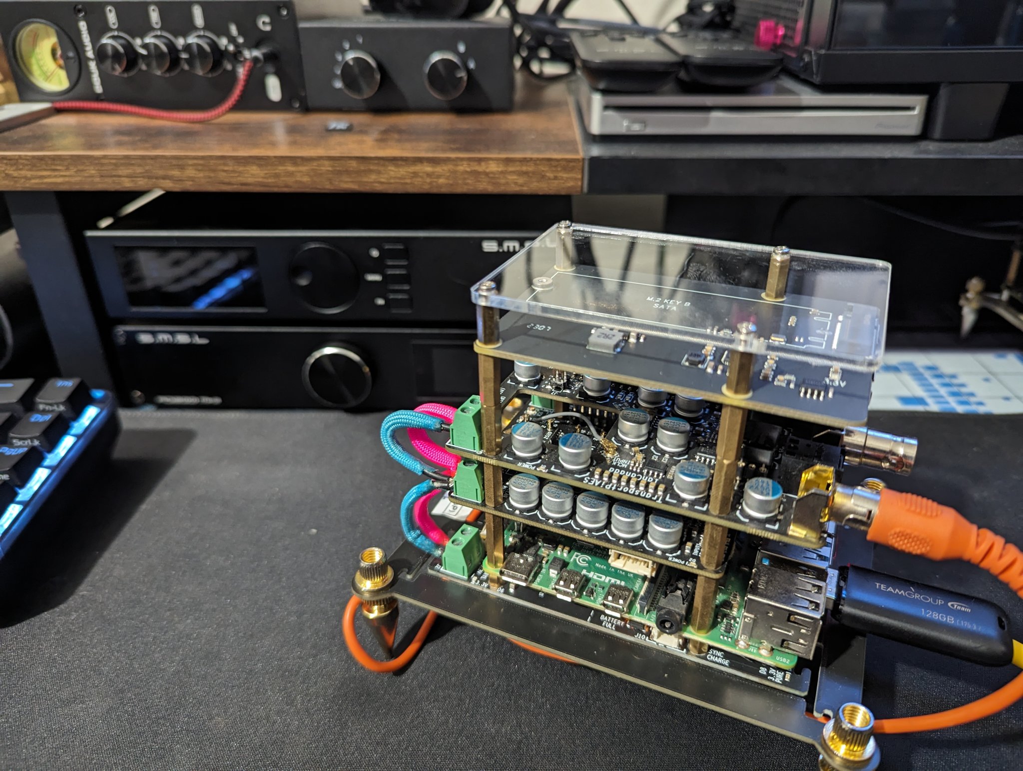

All parts are now installed. The only thing I can not get to work is the USB input on the receiverpi ddc with the amanero board.
I installed the drivers on my PC without issue and am able to select it as an output device once connected but I get no sound output from the system.
Optical works flawlessly as well as coaxial. Just no love from the USB side of things.
If anyone has any ideas on how I can get this working I would greatly appreciate it.

Hi @bhjazz !
The issue was in my computer seeing the input but never actually being able to output sound even though media was playing. It just always stayed muted. When I go Optical (toslink) or Coaxial though, it functions flawlessly, so I use optical and am honestly quite happy with it. I have since removed the USB section as like I said I could never get it to function as intended but I assume that is on my PC side and nothing on Ian's end of things. 🙂

It honestly sounds fantastic! All the connectivity is a huge plus as well. I also added a second 1Tb M.2 drive and it performs flawlessly when switching between the drives and the network share. I have not a single complaint. It beats the other 3 DAC setups I have pretty handily. The closest to it is my OPPO.
