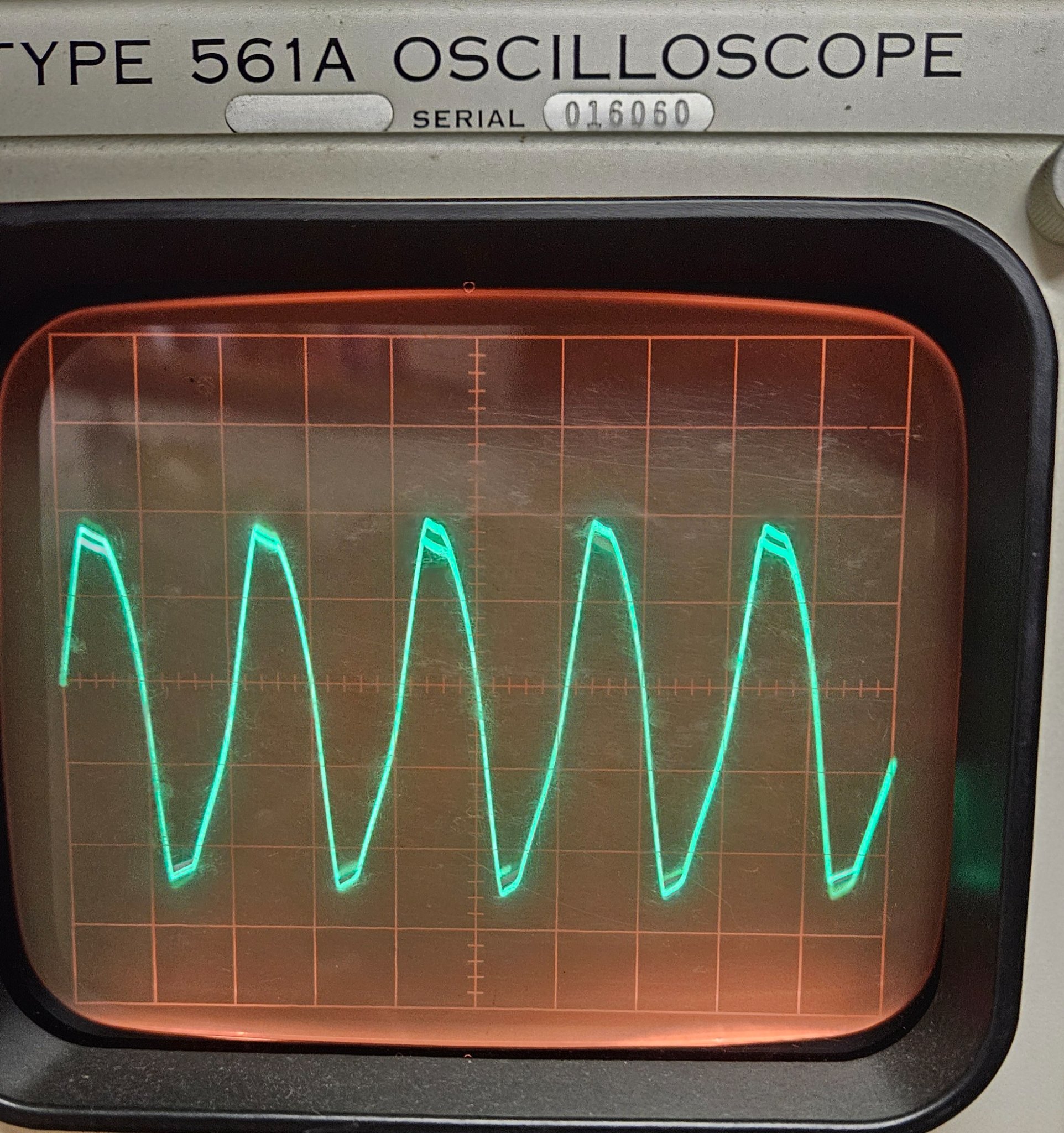

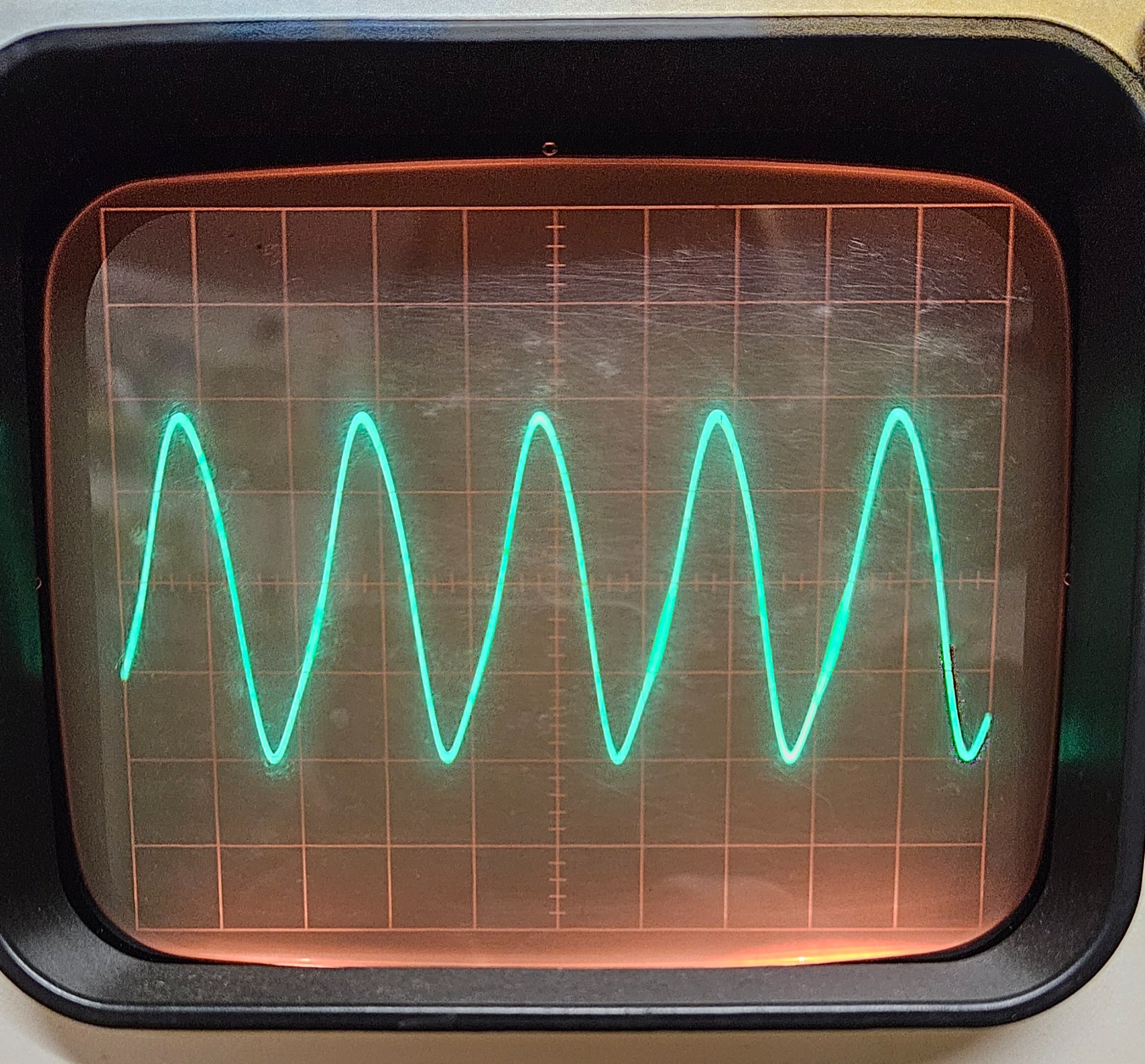

I've got the tubes biased around 40mA each and there is little difference in power output.
Now i have my signal generator set to 150mV @1KHz and the speaker output reads 28V which is 98W on myb8 ohm load.
If i feed in a higher signal it doesn't clip until around 170mV, see photos attached.
The guys on the marshall forum are telling me that the marshall design should only require 10mV to reach full clean power output.
I'm stoked that it's giving me 100 clean watts, but they are telling me that the phase inverter is to blame in this regard, i can only get about half a watt if i feed this with a 10mV signal.
I also have both volume knobs on full to reach full power on the low gain.

I guess the 10mV sensitivity from the marshallforum means 10mVrms corresponding to 28mVpp.
I expect the typical Marshall power amp using a 12AX7 PI and EL34 power tubes to have 4 or 5 times more gain than your amp.
I see 3 options:
1) Leave the amp as it is as you seem to like it.
2) Increase the series NB resistor for more gain but less presence. (Leo Fender knew that a 12AT7/6L6 power amp doesn't allow for effective presence boost.)
3) Convert the PI to the 12AX7 Marshall circuit for more open loop gain and also increase the feedback resistor for more closed loop gain and moderate presence boost.
