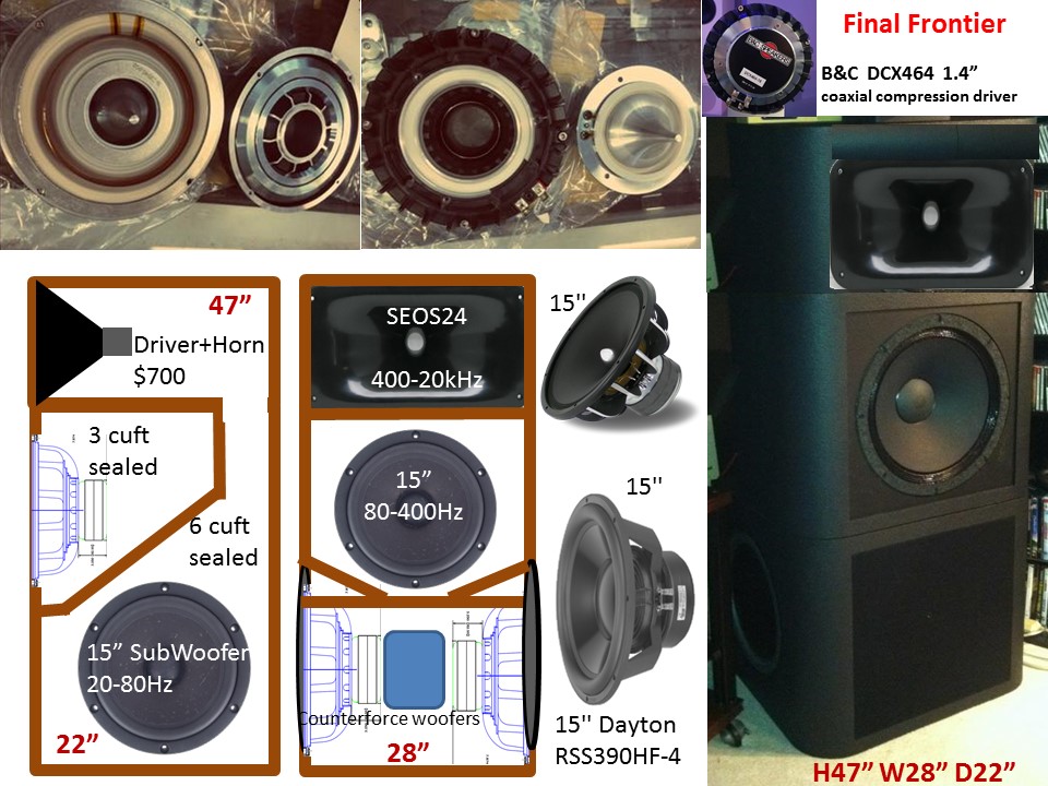

========== The Final Frontier 4-way =====
new tech DCX464 2-way coaxial compression driver ~$600 + $200 SEOS-24 waveguide
----passive crossover on DCX464
-15" midrange in sealed volume (like Faital 15PR400 AES TD15M bms 15N830v2 )
-two sealed and equalized Fs=18Hz 15" subwoofers like Dayton RSS390HO-4 one amp per speaker
