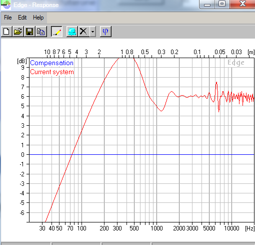

Here's the response sim from the edge based on the modified dimensions for the setup with the numbers as-run (drivers out of electrical phase). -3@ 100, and it's probably flatter than the "idealized" setup due to all the randomizing elements, but if this is accurate from a peak perspective, a simple notch at 400 could let me run a 100hz XO very comfortably.

Thanks Charlie- I think that because of the symmetry, cardioid operation is not the case on them as-set, but could be achieved with some additional manipulation. I'll plan to take some measurements over the weekend and see what exactly is happening- the 100-500hz range is where it's critical for me to see what's going on- it's in heavy cancellation below 100 and the baffle acts much like an infinite baffle above.
