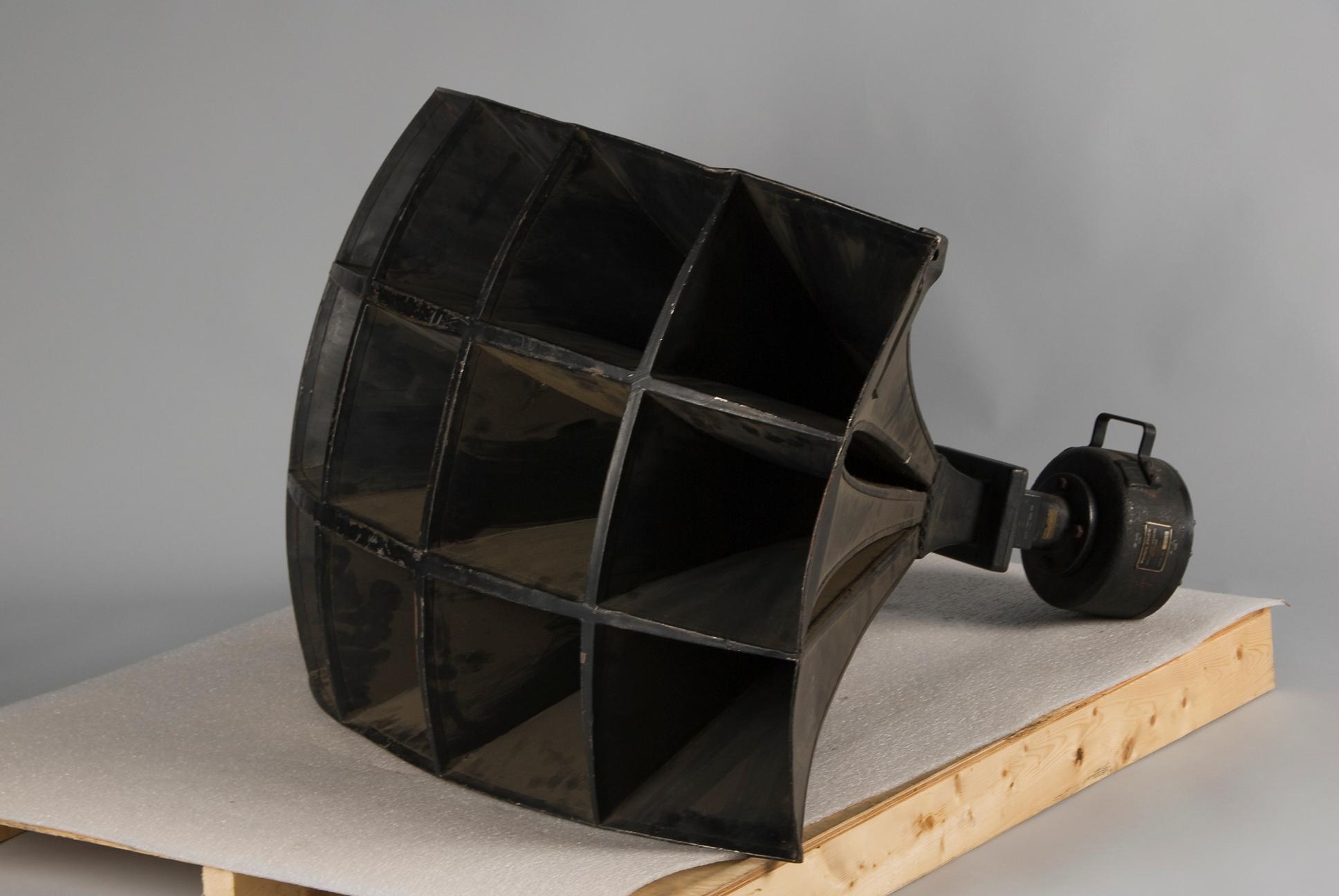

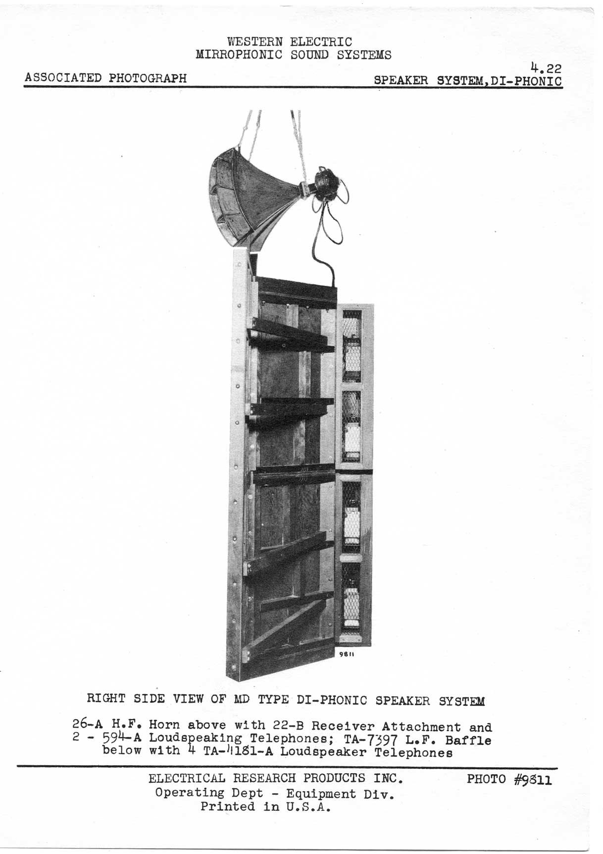

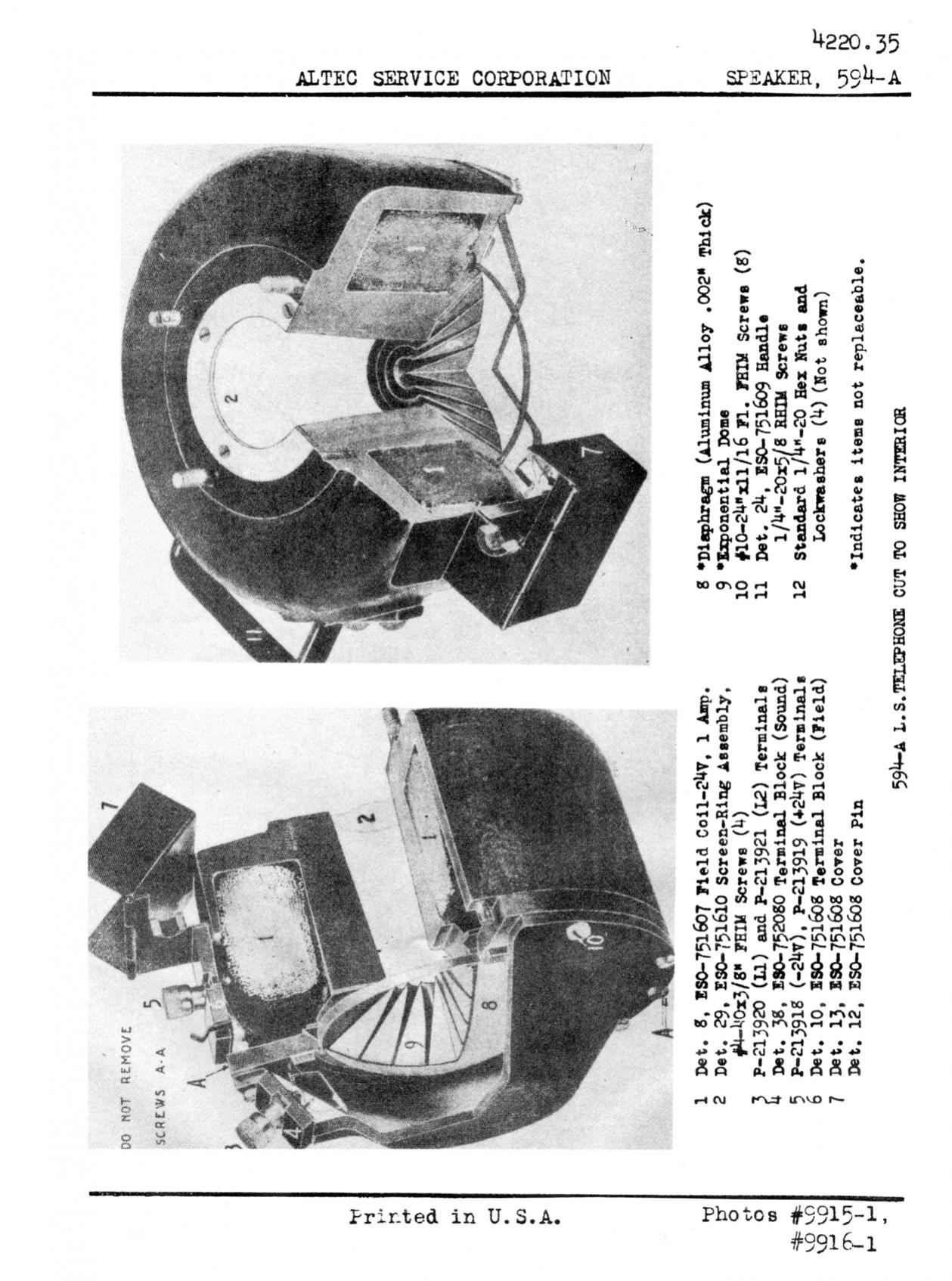

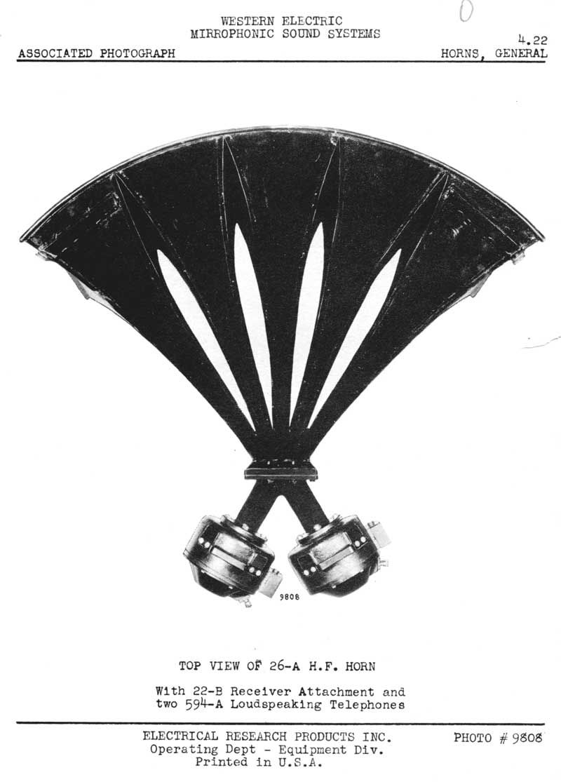

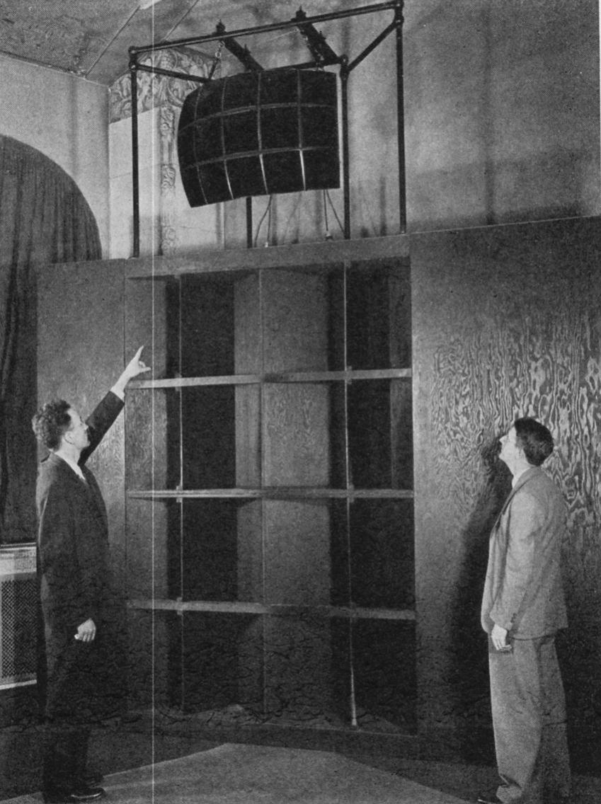

Joe Roberts, representative of G.I.P. Laboratory / Silbatone Acoustics and WE aficionado:
"I can look you in the eye and say that the 594A is the BEST compression driver ever made. This was part of the second generation WE engineering coup, the Mirrophonic systems.
These are far more scarce than 555 drivers. They were only out for two years or so before WE abandoned the theater business. A truly cost no object driver. To buy the cobalt used in the pole piece and yoke costs a couple thousand bucks today. These mainly went into large fancy theaters.
594As went on multicells in proto VOTT type systems, 300hz LF cutoff. 18" field coil woofers in open back horn baffles. 86 or 91 model 300B amplifiers.
I saw an ad for used theater gear in the early 50s and a complete Mirrophonic model 2 system, possibly including the electronics, was listed for what the inflation calculator put at near a quarter million bucks!
No more efficient driver was ever made. Also, a mostly unknown feature of that driver is this: All midrange compression drivers exhibit a mass rolloff starting at about 5-6k. The rolloff on the 594 approaches the theoretical perfect maximum output and is controlled within 0.25 dB, so that when a simple 6dB peaking network is placed in the amplifier (one cap), the output is flat to 13k. An RCA engineer I know told me that they were adjusted for minimum group delay under this condition...in 1934!"
The WE 594-A / WE 26-A combo (image 1-3) was used in 1936 at the Tercentenary of Harvard University.
Dimensions:
99.5 x 94 x 59.2 cm, 130 lb. (39 3/16 x 37 x 23 5/16 in., 59 kg)
The loudspeaker is marked in several places "NDRC" and "An. Res.___LLB." This indicates that it was used by Leo L. Beranek in his Electro-Acoustic Laboratory during his classified research for the US Navy on mitigating sound in combat situations. The equipment was marked and the project was put on Harvard's books as "Anonymous Research by Leo L. Beranek" to keep it a secret. NDRC stands for National Defense Research Committe.

WE model 26A horn with 594A field coil driver loudspeaker used by Leo L. Beranek.jpg133.9 KB · Views: 992
WE model 26A horn with 594A field coil driver loudspeaker used by Leo L. Beranek_2.jpg168.6 KB · Views: 493
WE model 26A horn with 594A field coil driver loudspeaker used by Leo L. Beranek_3.jpg217.9 KB · Views: 499
