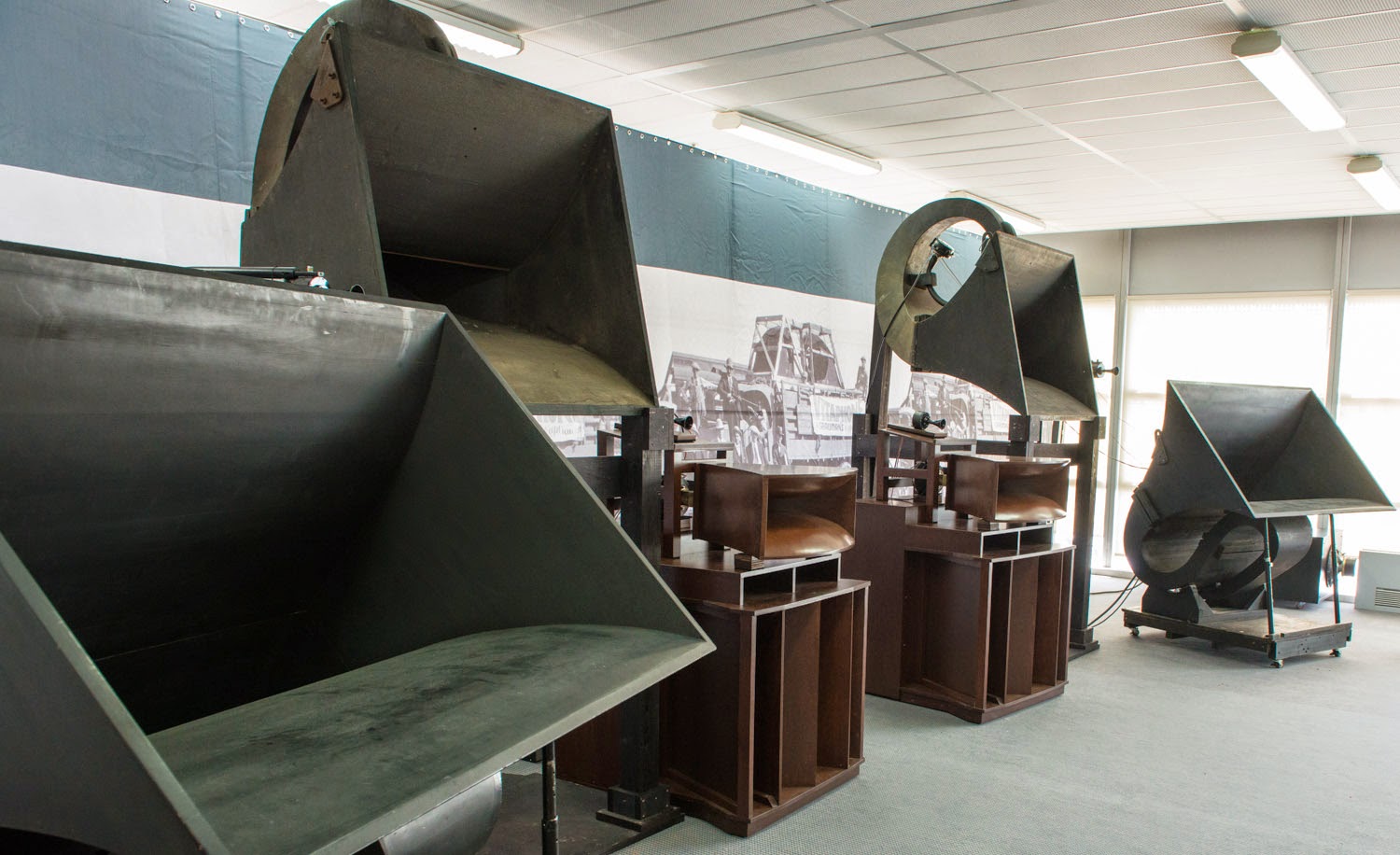

I often look at the Western Electric horns. As a lover of vintage speaker systems, these are discribed as the Nirvana of speakers, an unmatched soundquality coming from a system developed in the '30s.
They are demonstrated often at high end audio shows (Munich Silbatone) with raving reports about sound - realism - dynamics.
And they are sexy as hell with those curves.
Butt...How is all of this possible? A design made in the '30s?
As we want to design a good horn speaker these days, we use computerprograms, we count in directivity - bandwidth - no folds in the hornpath - ... Are the WE horns breaking all of these laws? Or are they just a vintage hype?
These guys?

What exactly is the Freq response of those large horns? They look like their about 8 feet long with about 4x4 foot flair, is that about right? Also what diameter was the compression dome and opening?
The big cinema 15A horns have an acoustical ~15 ft path-length/8 ft square mouth IIRC [~14 ft/4.7 ft square actual] for a nominally flat 100-5000 Hz [AM radio BW] response, though could have been [was?] used higher/lower as more signal BW was squeezed onto the film strip, so if you want the 'ultimate' mono speaker for that primo restored Gramophone, AM radio or early 'talkie' DVD/bluray movie playback......... 😉
Something I forgot to note earlier is that as good as it is, the 15A needs some bracing/damping for HIFI apps; or for a bit more compact, better constructed/performing option, the 12A [first cinema horn] with a ~300-4500 Hz BW is preferred and if later you need some bass reinforcement as W.E. did, there's the add on 13A bass horn. 😉
It's a 2" VC/1" exit AFAIK, don't know the actual dome diameter, but these folks claim to know/have all the specs: GIP-555 / 555W
