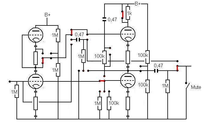

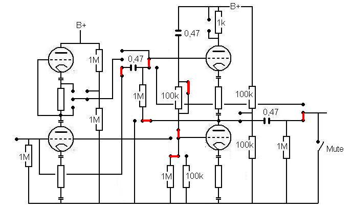

After that he published a schematic with a little gain, using a SRPP 12BH7A into a 12BH7A WCF. I was tempted to build it…but than the Aikido already made his entry in the scene and I didn’t exactly know what to build anymore. I remember Frank posting a comment that the Aikido was new for him, but short after that he posted the schematic of the SRPP 12BH7A + WCF 12BH7A again, to show it had lots of things in common (at least in the wiring). So I thought about the possibility to build something more universal, which implies in the possibility to easily change cathode/plate resistors for different tubes/current settings. I didn’t want to solder and desolder it every time and I finally found a solution for this, inspired through http://www.artemislabs.com/docs/PL1_Manual_1.pdf amplifier - the ZIF socket. With this one it’s possible to easily change resistors, and it probably will work very well. For other connections it is possible to use jumpers (well, I will build a prototype on veroboard, so it is easy to use jumpers).

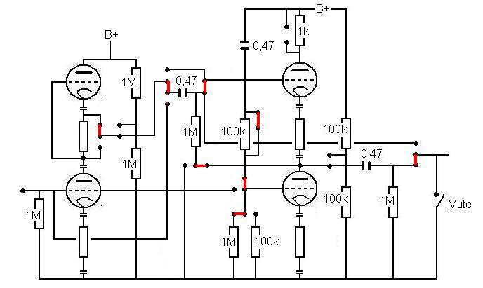

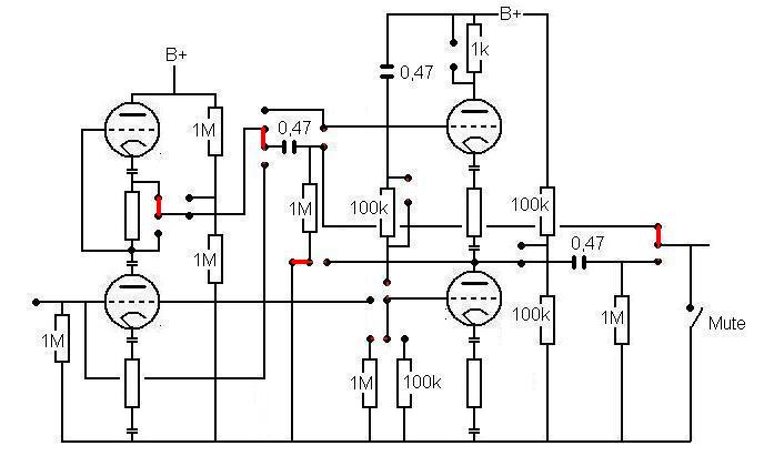

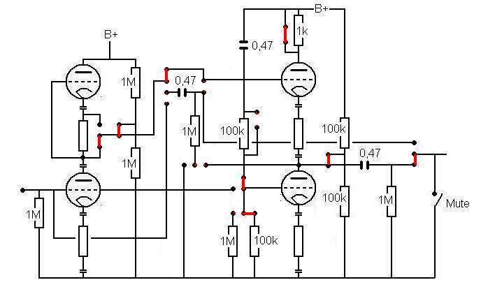

Today I spent some time in designing the more universal preamplifier. Well, it is not actually designing, I just put some freely available schematics together. With different settings of the jumpers it should be possible to 'create' a SRPP amp, a WCF, a SRPP + WCF, an Aikido and a Gomes amplifier.
Issues like the power supply and exact values for the cathode resistors (and the plate resistor in the SRPP) I haven't put here. Power supply van vary a lot. A 6BL7 in SRPP will be happy with 390VDC, almost the double of what the ECC88 can take...so power supply depends on used tube (B+ aren't tied together, but should be). The Aikido design allows one to change tubes without changing cathode resistors, but I like the idea to easily change the settings of the used tubes - that's why I will use the ZIF socket (in the schematic a 'ZIF connection' is shown as two parallel lines, a bit like a capacitor). Jumper pins are shown with the dots, the actual jumpers with red lines.
I post it here and I am sure comments will arise, given the popularity of the Aikido and the 12BH7A WCF, about two years ago.

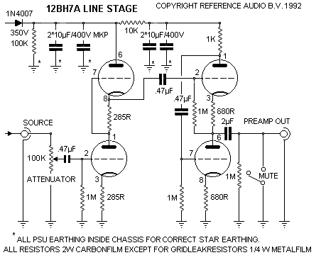

First schematic is that of the SRPP 12BH7A + WCF 12BH7A
Erik
PS: and if it all seems to strange - I got the 'valve amplifiers' book as a gift for my graduation and I can take some theory from there.

Wow..great Erik...I would call it universal gain stage though..because you could just as easily use it to drive an output tube...etc..etc.
Bas Horneman said:Wow..great Erik...I would call it universal gain stage though..because you could just as easily use it to drive an output tube...etc..etc.
Sure. I am full of ideas of building different DAC's and riaa amplifiers, I/V and amplifying stages, solid state and tube based etc. But than there is a myriad of designs that can be used for each aplication, and each I want to try. But building each individually would take to much time and, as I like to work from scratch, I would use one kind of capacitor in one and another in the second, so comparisions wouldn't be fair.

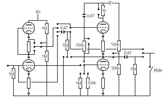

Attached is a version with three more ZIF 'slots', allowing the assembling of the 'simple line stage' from John Broskie. Only the first tube is used (it should be a 12BH7A). And so you can go on...

BTW I think there is a drawing error- the cap should go to the anode of the WCF, not to B+.
Now, can you make it do mu-follower too 😉

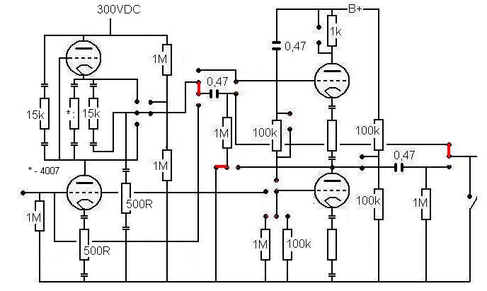

I have to build some pcbs for a line stage preamp, so I was thinking about a design like Erik's, that can be used then also like a driver for a tube amplifier, etc, etc.
I have started the design of the pcb as per Erik hints, I would like to include in the possible configurations also the dcmb. If the pcb won't get too complicated, I would like to put on it the octal and noval socket.
I need from you guys a kind check on the schematics that Erik proposed, I'll make available the gerber file when completed.

update
having a look at Erik's schematic, I think that I will not put a connector just to bypass a component, rather I will solder a jumper if needed.
Or do you think it is convenient to leave the connectors?
