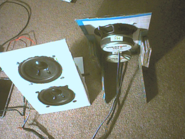

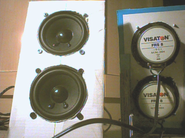

Anyway, I had some cardboard lying around, and 4 Visaton FRS8 speakers, so I decided to make a pair of near-field U-frame OB speakers. The amp you can see powering them was gutted from a pair of PC speakers, so it fits the bill nicely.
The sound
I'm not going to beat about the bush - it's not brilliant. The treble isn't quite right due to things like comb filtering, the bass is almost non-existant. Even so, it's not bad for what it is. I put them together with no calculations. The height for the sides was the height of the shoe-box I used, I only doubled the baffle thickness because I didn't want them to fold in half. But hey, it was fun - they don't go that loud, but they sound Ok for what they are, which is a half-hour build with the stuff in front of me.

how are the speakers mounted on the cardboard? is it thick enough to hold them? don't they want to fall down?
I doubled up the cardboard, and sandwiched the drivers between it. Then I added "feet" at the back, which double as the U-frame. It only really covers the bottom driver, so the top one is a simple OB.

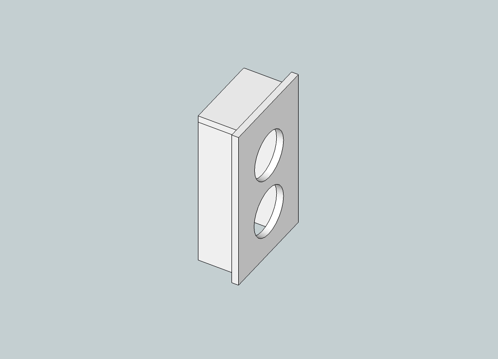

Yes, the drivers themselves are suitable - Qts of around 1, but the fs is too high for any meaningful bass (120Hz).
I did make, using the same drivers, a design that cancelled the rearwave of the OB speaker - this gave a 6dB/octave rolloff, without the need for a huge baffle. Meaningful bass down to 60Hz, not bad for a 3" driver.
I should probably re-do those, but with some kind of calculation for the sealed box behind the OB driver (LP around 300Hz), so the excursions come close to matching. The midrange was very nice, but the design itself wasn't suited to rock etc, where you need lots of noise. Did extremely well with girl+guitar things, light music (Paul Weller).
I know OBs sound good, but my room simply isn't suited to them - I have little space for anything large, and there's furnature everywhere (my bedroom), so my little OB+rearwave cancellers are all I can use from that category.
