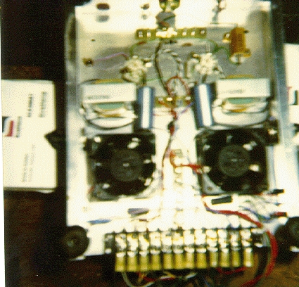

Possibly 4CX250, which is a VHF transmitter tetrode that used forced air cooling.
Eimac made little socket and chimney sets to place the tube in a ducted air flow.

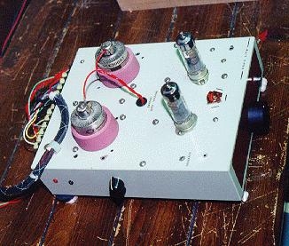

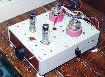

I briefly experimented with a pair of these in a guitar amp application. It is not trivial to make an amp with these tubes that remains distortion free from less than a watt, to 500 watts, and does not oscillate at RF.
I did manage to make a RF amp that put out 250 watts on 146 MHz using a pair of these with a copper pipe resonant plate line. It ran reliably for about 2 years until I built a solid state amp that made more power from 48 volts! I sold the amp and all the spare tubes at a hamfest.
It seems a tube for running electrostatic speakers directly. 813 also? Thanks for the advice. Colleen hates me working on tubes. As I tell her even a toaster is dangerous. I doubt any tube amp is safe really? I was working on florescent strip lights live last night ( my choice and made the job quicker ). Even that was unsafe.
Bob Danielek designed an amp using the 3CX300A for 600 watts; I made one using the same tube based on a Japanese design, Push pull from Glass audio. I started off using the 4CX250 wired as a triode later changed it to the 3CX300A when I got some cheap. I used about 450 volts; you just need a computer fan underneath each tube. Amp has run for many years, just recently the Toroidal shorted out, so need to get it running again. I have the output tubes under cover, so you can't touch them!!! 1900 ohms Plate to plate.
A pair of 250's should have been able to make more than twice that power, even at 2m. Were you deliberately running them conservatively?
Nowandays you can get 1200w in the 2m band with a single Freescale MRFE6VP61K25H. It takes 50V and 50A to make it happen, and you cannot skimp on the thermal management of the device.
Yes I could have squeezed more power from the 250's, but not from the power supply I had. It was rated for 1100 volts at 200 mA and I was pulling about 300 if I remember right. This was about 15 years ago, maybe more.

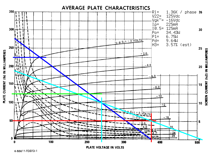

as you probably know by now, TV power tubes like lower g2 voltages than the regular audio power tubes, so that voltage doubler type psu's are very effective here...
and do not be dismayed by the lower plate ratings, they can survive higher plate watts...
finally the cathode ratings are far bigger than most of the audio power tubes, yes more than the kt150...

Well, it's a vertical sweep for color TV instead of a horizontal sweep. 19 Watts, like a bigger 6LU8 pentode.
