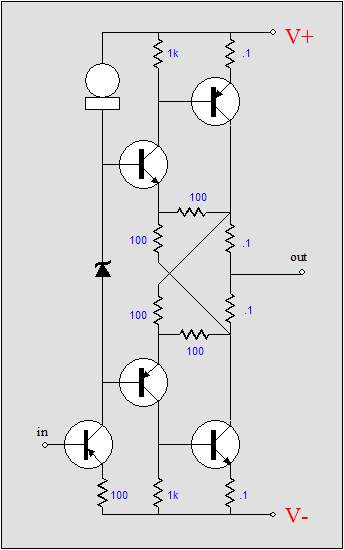

Junm My 36/40KD6 Sylvania and 18GB5 El menco (that is Japan made) arrived from ESRC. Any Ideas or suggestion for PP amp or screen driven amp that suits these TV tubes? I have 5K/8 Opt around 30w or more to use....what B+ is needed and bias current? [/QUOTE said:It seems there are some interests for amplifiers made with 'sweep' tubes. I have made a real workhorse for 30years ago. It happend because via my job as a TV & Radio repairman felle in love with PL519A and the exspired EL503. I thought that one day I would like to hear this big power tube play music and I have never regret that.
I have no schématic (only in my head) but it goes as simple like this...
Many different tubes can be used here except for the output that has to be PL519/509 or similar. The driver and input is ECC85 and I asume that most peoble know how to find a propriate plate resistor to any tube. I ALWAYS seperate the power supply for the small tubes from the big ones. I want a stable supply for the smal tubes. I even use a stabelized for the input.
The output tubes run on 300V (3000uF) and the bias is ca -83V (100mA)...that means that the driver should be able to deliver least 200Vpp. To do this it need 430V supply because it loses 90V over the cathode resistor. Its conected to the input without coupling capacitor because I found that gives a more stable amplifier at full throttle. The output transformer must have an load impedance between 1600 to 1900ohm and be able to handle 100W at 30 HZ
I make the 430V by a voltage doubler from a 160V winding which also supply the output tubes filament; 40V X 4 = 160V...but the new amplifier I am building now are using EL509JJ. Thast means the new power transformer has a 6,3V 10A winding.
I also want to try another driver ECC99....
Why I use Ultra Linear coupling
Because it gives an output impedance on 0,8ohm and a damping factor at 10...before feedback is applied. When..feedback which is only 12db is applyed...then the damping factor increase to 40 which I am very satisfied with. When/if tetrode coupling are used it would be impossibly to get this prober output impedance...not even with 25db feed back.
I am aware that PL509/519 are scarce by now...but EL509-JJ is a VERY good replacement and made for audio. I call my amplifier for; *THE FINAL AMP* because I have never wanted any other amplifier. My friends who also have one claim the same..
Oh yes...it delivers 85W at 0,3% distortion and can run ANY loudspeaker...no need for 4, 8, 16 ohm tap here...thats one of the reasons I created this amplifier ... no speaker is only 4 or 8ohm or anything else. Therefore, an amplifier should do it all unchallenged. This leads to the sound...

B + is 600V and it kills the tube. It is designed to work well under 300V as it does in the CTV sets.
The B+ in a color TV set may be in the 300 to 400 volt range but the Horizontal (line) Output Tube runs on the "boosted B+" or often just "boost" supply. This is a bootstrapped supply using the positive voltage developed by the damper diode (tube). Connecting a voltmeter to the plate of the HOT is usually a quick way to destroy a meter. You can measure the tap on the flyback transformer that has an electrolytic cap to ground or B+. This is the boost supply that runs the HOT and a few other circuits. It can run 400 to 600 volts depending on the size of the TV and it's deflection angle. The negative peak during retrace goes into the KV region, but the positive ramp on the plate can go above the AVERAGE boost voltage too. You can see this on a scope with a LARGE voltage divider, but accurate voltage readings were not possible with the equipment I had at the time.
Running a sweep tube in a circuit designed for a KT88 kills the tube because of the high screen voltage. A sweep tube wants 150 to 200 volts max on the screen. Some will run at a higher voltage in triode or UL, but beware a random runaway may happen as the tubes age. I found that 6LW6's will work and sound nice at 400 volts in triode, but a year down the road a tube will red plate and fry without warning.
I have run sweep tubes at 650 volts on the plate with no failures or shortened life in audio applications. I, and at least a dozen other builders assembled 125 WPC versions of Pete Millett's Engineers Amp running 600 to 650 volts of B+. All are still alive and running after 3 years. I have a design for a 13GB5 amp that uses combined G1 and G2 drive for over 100 WPC. It ran at 125 watts for 6 hours without issue during initial testing. The key to avoiding early tube death in a sweep tube is to keep within the peak cathode current rating, the max dissipation rating and stay well below the max screen grid rating. To get serious power within these constraints requires a fairly high B+. The minimum idle current to keep distortion low at milliwatt power levels imposes a maximum B+ value due to idle dissipation, which should be 1/2 to 2/3 of max rating.
Please don't tell that to my tubes...then they might blew up for first time in 30 year's. They are still doing fine in my amplifier and I suspect they will continue many years in the future.
That I have made 24 amplifiers that works on my way should convince everyone that it's okay to run the tubes in this way. If not, they would probably break in a short time, but they keep that said 10-15 years without problems. I would say they have a good life in my amplifier. If this is not convincing, I do not know what to do.

6KG6/PL519 is rated 250 V max for g2, while 6KD6 is rated 200 V max on g2. One can run the 6KG6 plate around 120 V below the screen grid voltage before the screen current really picks up. (see curves linked)
So using 43% UL and 300 V B+, with the plate dropping to 180 V, the screen will have dropped to 249 V. Just squeaking by the 250 V max g2 rating where it starts to count (plate current going up).
With the plate dropping to 90 V, the screen will be at 209 V, just hitting the 120 V difference (Vg2-Vp) safety margin at the 90 Watts (peak) output level (before xfmr losses). (45 Watts average sine wave, but real audio is peaky)
(On the positive plate swing, the plate V is well above the g2, so the plate is soaking up most of the current, and the plate current is low anyway.)
So Tube mania's design is running within the safety area, avoiding heavy screen current. But just inside. An 85 Watt sine wave might smoke the tubes.
I would be careful with the 6KD6 or other lowish 200 Vg2 max sweeps in UL.
I am not saying that your method doesn't work. It obviously does. Some sweep tubes can handle 300 volts in triode or UL and some can't. Sometimes one brand of a particularly type number can eat a lot more screen voltage than another brand of the same type number. The 6AV5GA and 6CD6GA are examples of this. I tested several brands of these in triode and found some stable at 350 volts while others showed a tendency to run away at 275 volts.
Many times this is due to the residual gas levels inside the tube, other times it's due to a different internal construction.
No...I have done all things to this amp we normally aviod. Open output with signal overload, to low impedance (3ohm), sine wave (8ohm 85W) for an houer.etc- Never seen red plate or gloving screens as I often se on EL34. I use to say: to kill this amp you must drop it from a high place...it cannot be done the normal way.
Output tubes are Siemens PL519A.
Running 85W o,3% distortion
