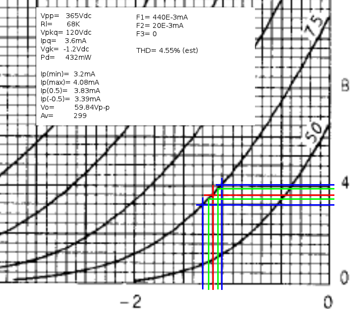

Small signal pents can make for excellent performing LTPs. Here's a loadline for the 6CB6 that could make a very clean LTP. Pents don't have to make lots of nasty high order harmonics. As for the HD finals, these really don't need a whole lot of drive, as they were designed for high sensitivity. This is accomplished by placing the grids quite close to enormous cathodes. This explains both the low screen voltages, and that these really don't need -- or like -- positive control grid voltages. Taking the control grids positive can result in excessive grid currents.
