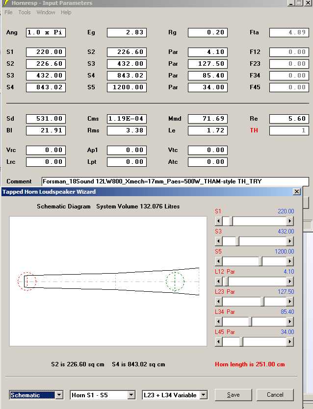

Hi Forsman,
Sorry I didn't reply earlier but (enough) time is sometimes difficult to find...😱
To be honest I think (just my opinion) that using Resonators/absorbing techniques only increases losses. I prefer to optimise the design rather than creating more losses. To me your 'dip problem' is the result of the difference between sim and design, like I stated earlier. I think it would be helpful to have a more accurate model to see what’s going on. It also help me 🙂 to explain what I meant with the cone volume correction.
The volume within the cone is usually the main reason why the dip is (usually) larger in measurements compared to the sim. In other words the volume at S2 in the original model doesn’t represent the volume in reality. In my post#23 of the "SS15 or Tham 15?" thread I showed an example of an alternative way of simming the THAM. The alternative model shows the dip pretty accurate and looks similar to what one can measure from a standard Tham.
To make such alternative sim for your Thorn F1, I used your measurements to go from. First, I implied your measurement within the graphic ratio of HornResp. This gives a much easier comparison tool between model and measurement. After that I made some small changes in the HornResp input parameters to correct the volume at S2 and S4 and some small changes for the correct position of the point source ( lays within the cone). When you increase the volume at S2 one needs to compensate at S4 in order to keep the correct total internal volume of the enclosure. By using the exact frequency location of the peaks and dips of your measurements I tried to improve the model further. In the next picture you see the result (black) in combination with your actual measurement (red), all in the same plot ratio.
The input page looks like this:
Now you have an more accurate model you can see that by making the S2 area smaller (Cone Volume Correction) you can optimise the model to what you have modelled in the first place. I did so by decreasing the volume of S2:
This example of the cone volume correction should bring it back to what you have simmed (freqeuncy response) in your original model. What this Cone Volume Correction will do is increase the compression at S2. Therefore the pressure minimums at S2, those of the 1/2 wavelength and full wavelength, will rise.
If you decide to experiment with the cone correction I made a quick sketch of how to start. You can experiment with smaller and larger shapes until you find the best solution.
Thank you very much Djim!
Don’t apologize for not having time. This is hobby and that is something we do for the fun of it and when we have time.
I really appreciate that you are taking you time to explain in such pedagogic way. I must confess that I didn’t really get it the first time… 😱 Your simulations show your point in a excellent way.
I must do some experiments with this Cone Volume Compensation.

Hi Forsman,
When you make a 'perfect' (afterwards) cone volume correction it will cause a narrowing passage at the edge of the baffle cut out. The example I gave you in my post (last picture) has about a 2 Litre correction but should be at the correct height at the source point (see help-lines within the sketch). It should be enough for correction but without causing obstruction of the horn-path.

I don’t know if this can be another way of simulationg the effects of the cone volume. I took my 2,5 l and added 2500 cc to Vtc (front chamber volume) and 531 cm2 to Atc (front chamber average cross section). That gives me this result:
(grey: original, black: with frontchamber/cone volume)
Not as close to the real measurements as your sim Djim but closer than the original sim.
/Forsman
Hi Forsman,
I’ll send you a nice Atlantic south-west depression this weekend to get rid off that cold. 🙂
The acoustic air within a horn isn’t affected by relative small sized shapes compared to the relative large soundwaves in question. It’s all about the volume per section and not the shapes. In other words, it doesn't matter how the Cone Volume Correction looks like as long it sits in the correct position on the horn-path.
So you can use Cone Volume Correction also sideways like in this example picture;
I am not sure why the Atc/Vtc function gives different results but I guess it's because sims use a 'flat disk' instead of cone shape for simulating the driver's cone.
