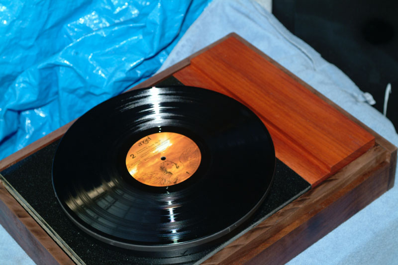

Td150
Mak is right.
The bottom of the springs sit on the washers and in turn on the adjusting nuts. The tops of the spring support the rubber washer and that supports thearms of the cruciform that holds the spindle bearing.
The cruciform/bearing/platter float on the springs.
Adjusting the nuts just moves the platter up and down and when incorrectly set tilts it as well.
Correct adjustment eliminates the tilt and this may give a better bounce. It should not adjust the frequency.
However, the sponges inserted in the springs may change the damping immediately after an adjustment and this temporary condition could lead to an apparently changed bounce. As the sponges settle into their new positions the original damping and frequency will return.
I rechecked the service manual (available for free download at VinylEngine.com) and it reads "the plastic gizmos raise and lower the chassis. Interestingly emough it shows an optional (disco balls) device to replace the springs in high vibration environments that look like little tennis balls or black rubber balls. So we are back to the beginning: put the TT on a stout stand, level the stand. Adjust the Thorens srews to level the plinth. Hope for the best. Many people, myself included, believe that the foam spring inserts are rubbish. I even tried filling mine with scraps of sorbothane. Probably did more harm than good by raising the fundamental frequency above 3Hz. Would love th know the stock Thorens spring rates. I used to have a contraption that had a scale on the bottom with a platform for the spring, an arbor press type lever to compress the spring, and a dial indicator on top to mesure deflection or amount of compression. So you would pull down on the arm a little, the scale would read 1.25 lbs, the dial indicator would read 0.25in, so we knew by simple division that that spring was 5lbs/inch. mayve if I put my digital phono stylus gauge in the bottom of my rifle cartridge reloading press, inserted the Thorens spring, taped my 6" machinists rule to the side, pulled down on the arm, read the scales and did the math, I would know the Thorens Spring Rate. Actually this would be darn accurate. I could see which springs had gone soft after 35 years of use. Thene I could buy a variety of springs from McMaster-Carr and Small Parts Inc to play with and fine hone the suspension. Sorry for the verbose reply, but sometimes waxing prolix clarifies the muddied waters of discourse. This maters to me personally because I need springs for my new DIY TT Thorens clone: see attached jpg.
