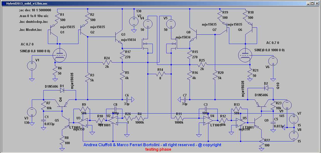

I don't like the cross feedback
What is from your view the main disadvantage by circuit from post #18 in opposite to that one from post #17 ?
The input cascode (at first look a differential amp) from post #17 provides rather an advantage compare with a normal one-stage input section from post #18.
OTOH - crucial should be the audible differences between both solutions.

yes the differential is not a bad solution about feedback

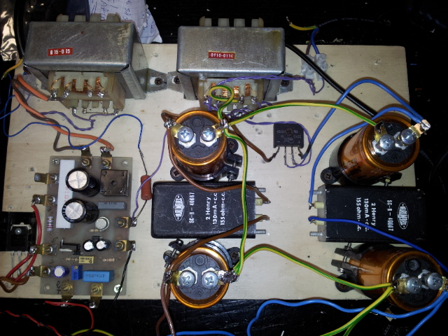

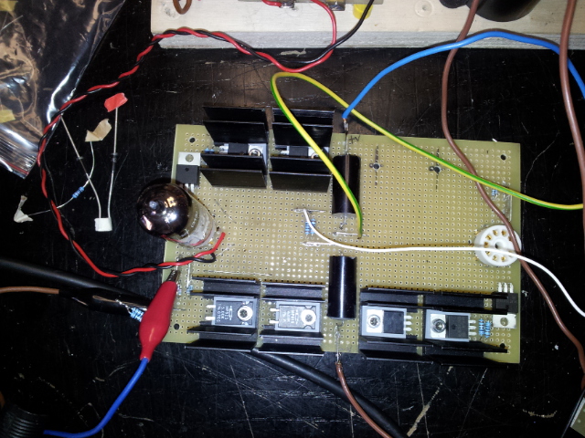

Actually I am working to a servo loop to have no dc offset because after some test with the hybrid configuration with mje15032 I have seen a very low stability using only a trimmer.

I would try to replace the tube with a VAS stage like this (introduced magic resistor and cascoded cascode):
http://peufeu.free.fr/audio/memory/memory-5-vas.html
This topology must actually clearly beat all exist small signal tubes in all respects, as long as high supply voltage is still present.

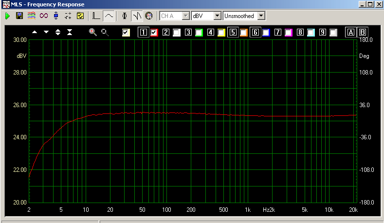

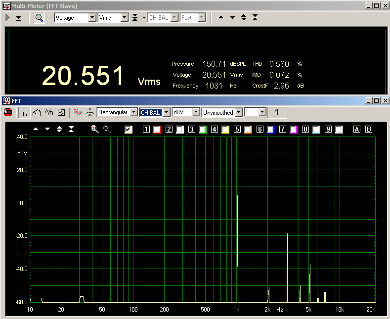

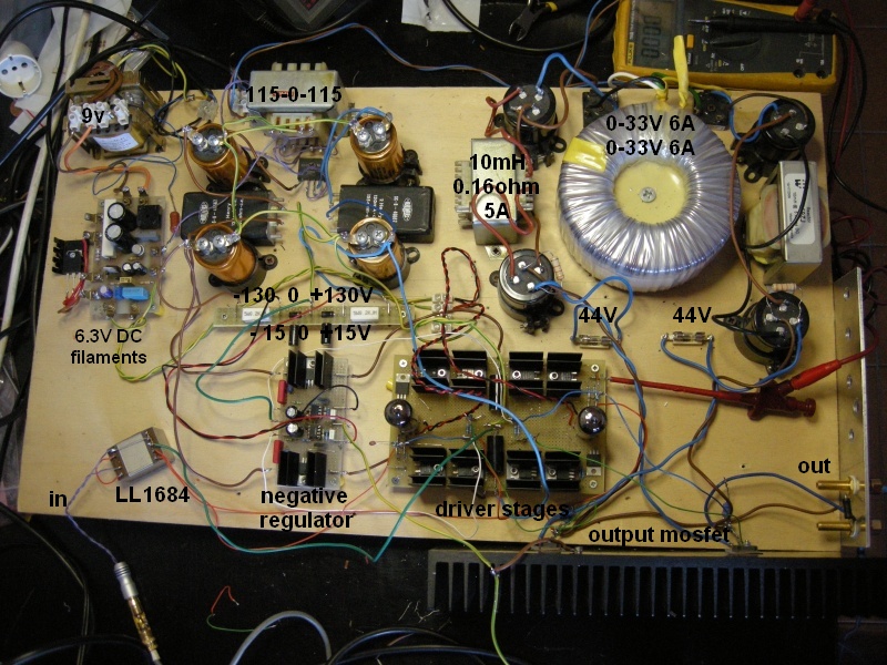

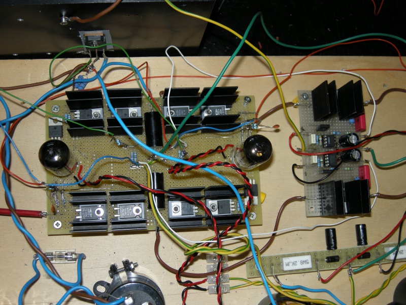

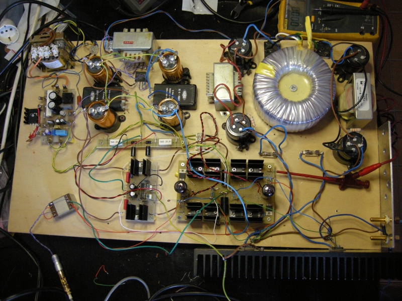

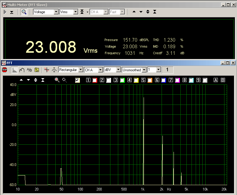

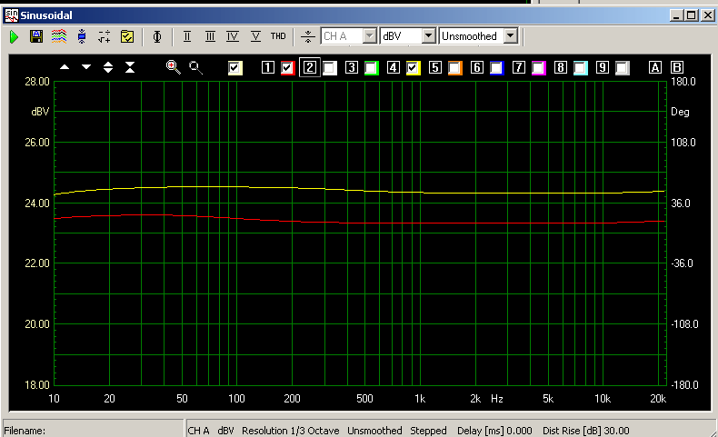

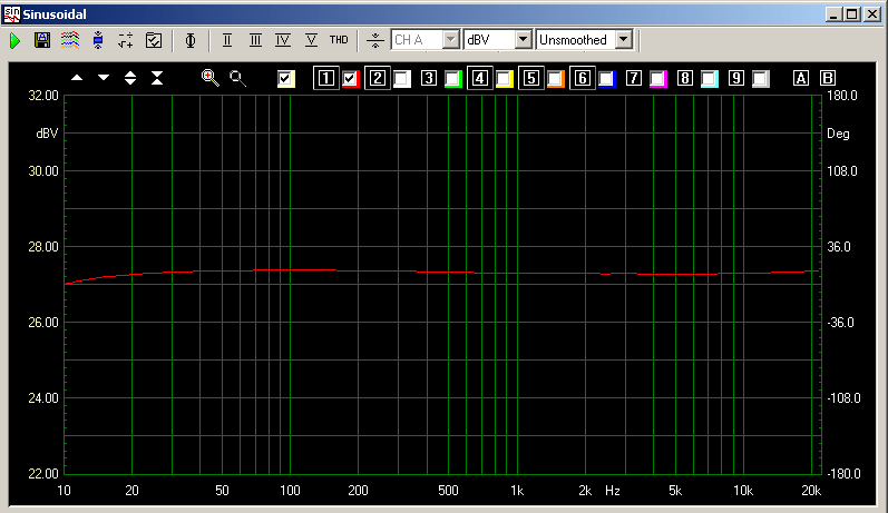

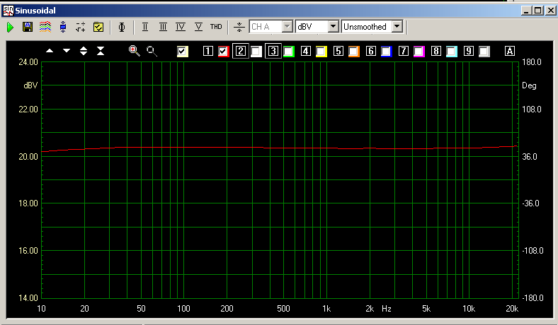

Last version measurements.
LL1684 Lundahl as input transformer to create the balanced input.
50W with 0.5% thd with a single pair of 2SK1058 at 44V DC.

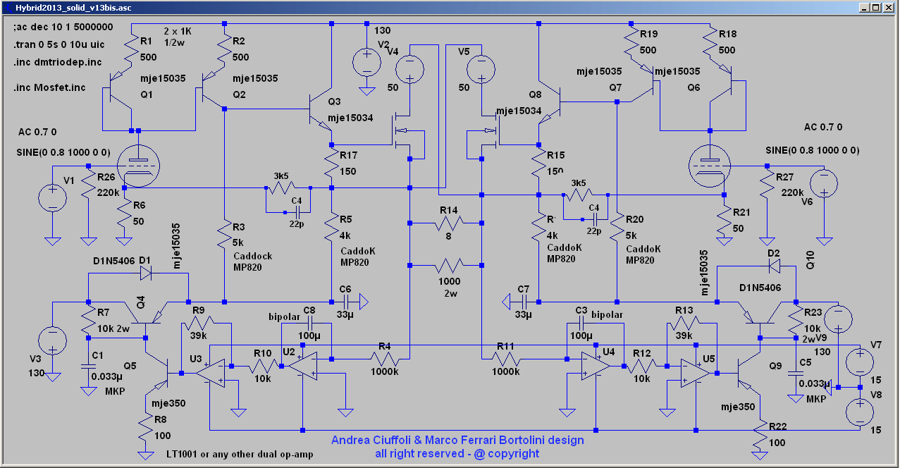

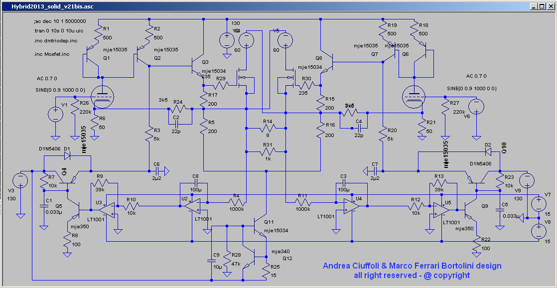

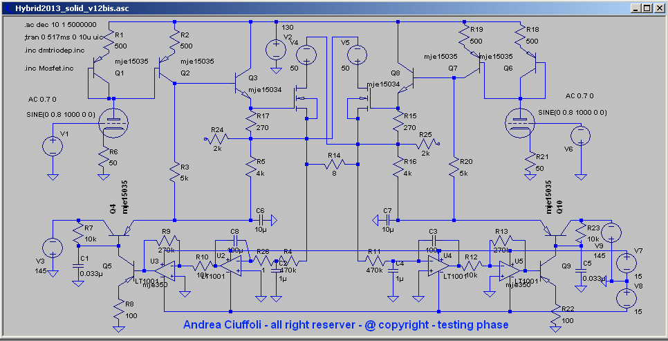

Last version schematic.

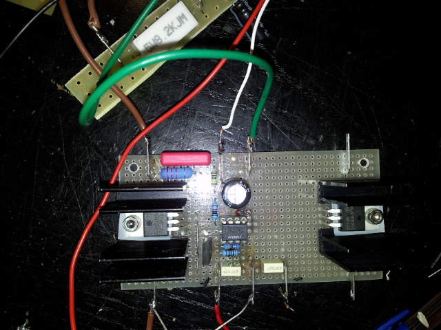

To use this circuit is necessary a simple DC protection with startup delay.
In the simulation about 55x without feedback and 29x with feedback 3k5.
I have used the D3a in triode connection but I will test soon also the pure triode EC86.

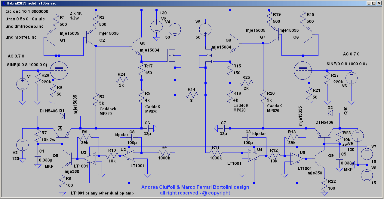

I monitor your circuit adventures. I wonder that your proof of concept didn`t blow up the main fuse. A little shift of tube anode current will cause a huge change of Mosfet drain current. I guess you have made some of these experiences. Your last circuit is a step in the right direction. But it violates Franks patent. Private use will be no problem but be careful with commercializing.
one little reminder: could you please anwser my question #30?
about question #30:
The main advantage of the configuration called "best pentode" is the very high voltage gain, but where can be necessary where this ? probably with a cascode you can create the same result.

Do you think there is a Franks patent violation on the new circuit using a current generator on driver stage ? The patent shoud be about the strange feedback create with difference and sum using opamp
I have buy this book to serach something about the second stage of teh Thorens.
For private use, there should be no problem in using patented technology not even posting schematics.
