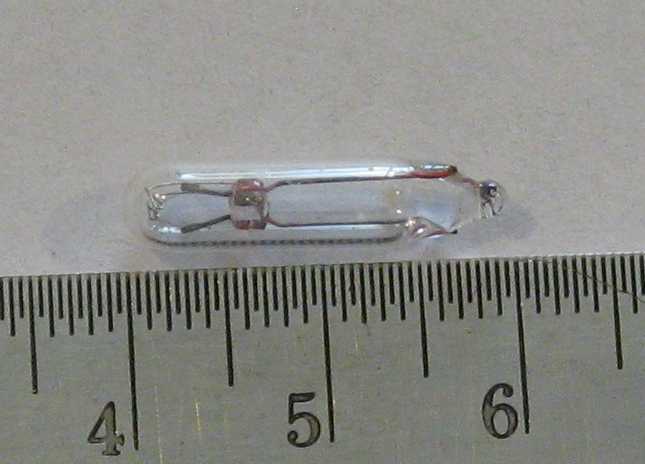

The amplitude control lamp in the oscillator circuit of my TD126 turntable has fallen off due to corrosion of the leads.
Would anyone know what it's ratings are ? I guess I will have to search for a similar part here . Any ideas ?
I've attached a picture. Cold resistance seems to be 85 ohms.
Know any sources ?
Thanks.

Thanks Mark.
I checked the TD125 manual an hour ago and discovered the lamp was 6V 20mA . But then I'm still not sure. I can however try to see what I can get in the market. The filament structure should indicate if its useful. This one has a very thin filament compared to some 6V lamps I have seen.
Right now I've decided to try and resolder an external copper wire to the small stubs ( maybe 0.2mm ) that are still there. It couldn't possibly cause any more damage. If it works , I can glue the new wires to the body and then it should last another 10 years ! It will give me enough time to find a suitable replacement.
Thanks.
Ashok.
That looks a lot like the somewhat old fashioned bulbs used in telephone equipment and some electronic test equipment. They usually have metal contact glued to each side so the bulb can be pushed into a socket. They come in all sorts of voltages and currents. You need a bulb catalog, Chicago Miniature Lamp or similar, then order something suitable from one of the distributors. Pull the metal contact off each side and solder it in. That would give you something that looked like the original installation, if you're into that sort of thing- I like my repairs to be invisible ;)
Hi Conrad and others,
The possibility of getting minature bulbs in our shops is almost nill. However "old" shops sometimes have ancient stuff stashed away. I went to one of those and he had a box full of tiny lamps and no specs on anyone of them. Most were with leads on them. I picked two each of five different types ( shapes and lead outs !) for about 50 cents !
At home I found one which had a cold resistance of about 45 ohms which was the highest of the lot. I put it in and the circuit is working again.
So I got the platter working with correct voltages and speed.
