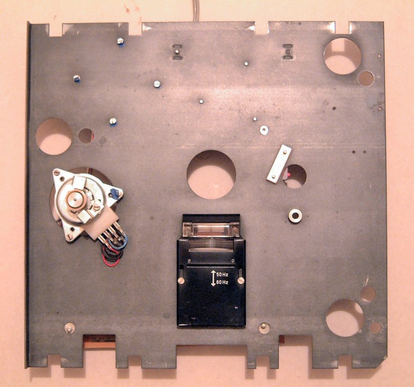

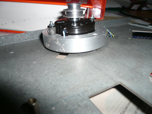

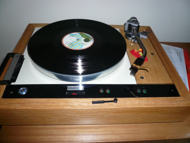

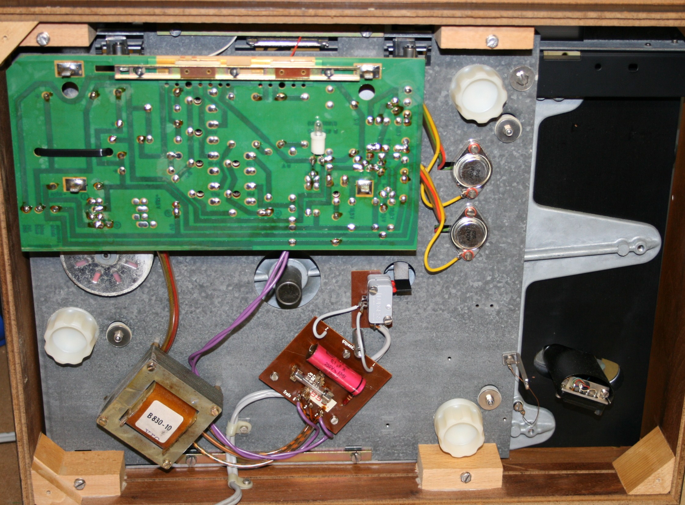

I bought my TD 125 MkII in 1982 and it has served me very well. I converted it to Direct Drive about three years ago using an inexpensive Technics deck as a donor! It wasn't an easy job, but works very well.
