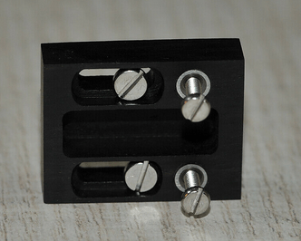

Perhaps a mounting slider/adapter can get the job done.
Screenshot 2022-04-12 at 19-19-49 Adapter_Slider_Mounting Bracket For Lenco L70 Headshell For ...png
https://www.ebay.com/itm/263706303685
