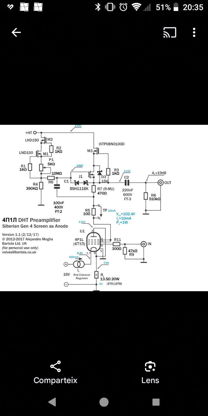

And for 4P1L as lineamp screen as anode?

Trioded 4P1L has enough low Ri for this IT.

I'm not sure, that 4P1L g2-g3 as anode has enough low impedance for this load.

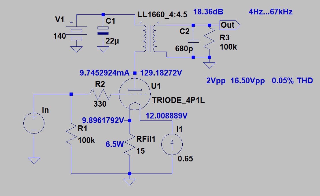

So what connection Alt Q 4,5:1 for Lundhal LL1660 and what schematic to use with 4P1L as lineamp?
Thanks Bela, C2 & R3 are to simulate the load, right?
The LL1660 needs zobel for secundary?
Do you know the output impedance?
Without compensation (series/parallel zobel/snubber) each LL1660 has enough large bump at few ten kHz.
The output impedance depends of ratio of OPT and tube's output impedance.

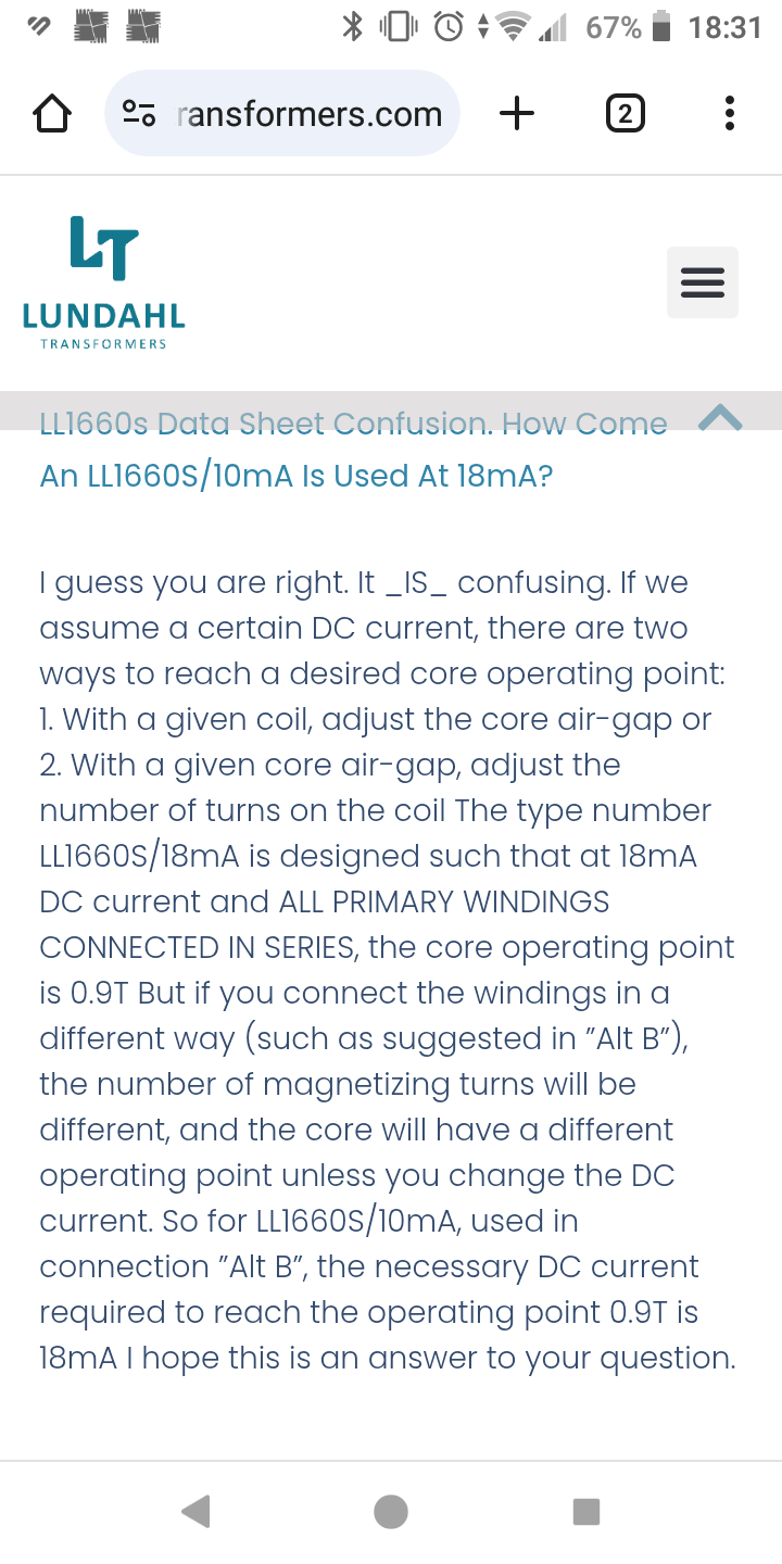

Nevertheless - I expect Alt S (all in series original primaries ) and Alt V (parallel 'primaries' in an inverted method = original secondary treated as input) to be the 'only' alternatives;
All in series, max 10mA? (yes of course. . .) So altS is already stated as correct specifically with 10mA - - because the type alteady says 10mA. [and that would give 130 Henry, BW 25-40k]...
In my bench top I did not get convincing results yet. - in what I tested there is ringing so I stopped investigating.
In setting up - There must be more, like an expected damping from a certain tube output impedance. ??
Or --> is the type correct??
I checked the Alt B. mentioned in the screenshot with the feedback from Lundahl. Now that gives a clue. LL1660S with Faraday shield might be the TM version; because that can be used in an Alt A. and Alt B. (The standard LL1660 has other alternatives, M, N, Q, ST, V. . ).
Test: are there two extra secondary pins 13/18 that should not have a connection, and tested with a capacitance meter (ging maybe 100pF)?.
