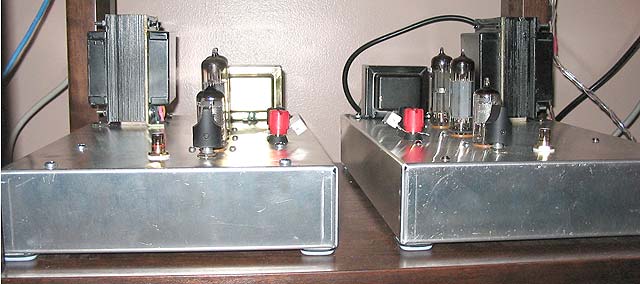

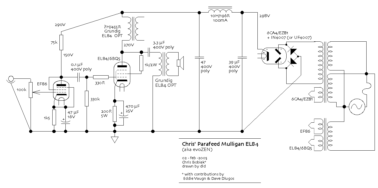

My good buddy went thru a couple ZENs and is now using a clone i call evoZen -- quite an improvement over the original. Built from mostly recycled parts it was quite inexpensive.
they are parafeed monobloks with triode strapped EF86 driver tubes... the only real relation to the ZEN is the outpit tube and that it evolved from a "close as he could get it" clone of the ZEN.

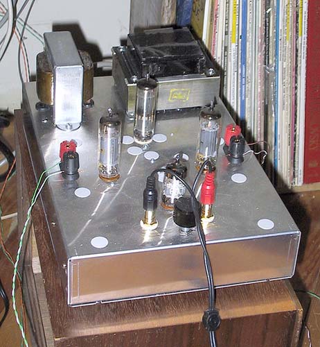

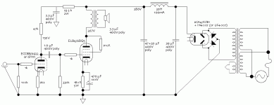

I was the fortunate recipient of the penultimate stereo version -- tossed in my own iron, and i've got a nice little Mulligan (ZEN clone)

Being a Frugal-phile(tm) and not cash rich i'm always using recycled iron from old tube kit. Most often this comes from old consoles i've gotten primarily to mine for their speakers.
In the case of the EL84 you need 5-10k primamry OPTs & about 80 mA/channel for the B+ which needs to end up at 250-275 V at the plate of the EL84. (actual draw from the tubes is just over 40 mA -- i like having a margin).
