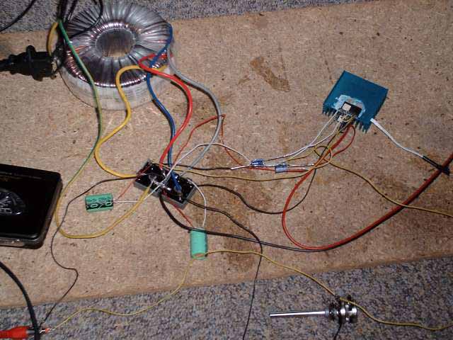

Bricolo,
Your problems are almost certainly due to layout. Even just a short length of wire can act as inductor, which will provoke oscillations in any high-gain op-amp circuit. My GainClone has no Zobel network at the moment, and is perfectly fine.
However, I will add them to the final versions, as they will help to ensure stability into awkward loads. It shouldn't harm the sound quality, and you shouldn't be afraid to use them. But it is wise to ensure that your amp is stable without them...
Mine take about 25-30mA per IC at idle, and run cold. Take a close look at the pictures on this thread (and on my GainClone page) for examples of good layout practice. It really does matter!
Post us a picture of your current setup, and we'll try to help 😉 If the above picture is yours, then definately rebuild it!

plug your scope to the speaker, and watch 🙂cowanrg said:how exactly can you tell if your amp is oscillating?
Hi Bricolo!
Like I postetd before, try shortening the wires (a lot). The GainClone layouts suggested by P. Daniels and others really rely on short signal paths to the IC, especially with the supply caps. Also the TDA is a little bit more picky about surroundings...

Peter Daniel said:All my gainclones had no problems so far, yet in one setup, for some reason the amp was picking up some freguencies and was possibly oscillating as well. I had the chassis gound connected to one channel analog ground only. I advised the guy to connect L and R channel speaker posts (connected to ground) together with a jumper and the problem disappeared.
my stereo amp uses one ground for both channels, so I haven't this problem
they use the same 2 diode bridges as well, and I saw that disconnecting one speaker, stops oscillations at the other
do you think that using 2 bridges per channel would help?

Peter Daniel said:
Where is the common point?
do you see my 2 diode bridges on the picture posted before?
they are connected on the ground point with 2 big section solid wires
all grounds are directly soldered on this cable connecting the 2 diode bridges
I don't know if one bridge is OK. If you want to use those diodes I would go at least with 2 bridges. And the diodes are MUR860 not 820 and either Motorola or On Semi parts.😉

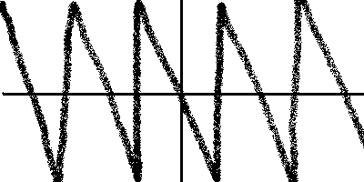

I just tested one more PS filtering cap directly on the chip
I put a 220uF on the +, and another on the -
stupid as I am, I bought 2, and I realised I needed 4, with a stereo amp...
so for now, only one side has those 2 220uF caps.
the other channel oscillates even more now! with the other channel's ( the one with the 2 new caps) speaker disconnected it still oscillates
but the speaker attached to the chip that has those 2 caps no more oscillates 🙂
even at high volume, even when the other channel's speaker is connected 🙂
great, I'll buy the 2 other ones 🙂
the bad point is that this side has now more hum :/ quite strange, since I added filtering caps
I looked the +V and -V signals at the scope, and my part of AC hasn't decreased, strange
it's still 300mV peak to peak, with a curve like the one in attached file
frequency is 100Hz (this only thing is normal)
PS: of course, I used the scope on AC, I don't only have 300mV AC, I also have 24.5V DC 😀
