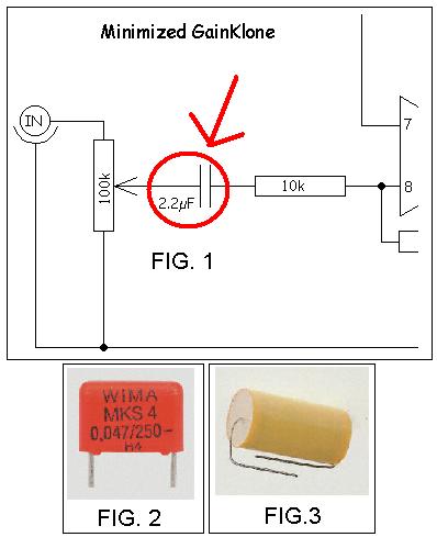

ok, for all the components, shall i just try the circuit with whatever components i have? (all the correct values and ratings)
for the capactitor here (see fig. 1) i have a load of capacitors that look like this (see fig. 2) (not the same writing on them by the way, just the same colour and shape), will they be ok, or do i need some completely different? like this? (ive seen a few of them used) (see fig. 3)

They look fine! Try all of them, and use the one you think sounds best! (I've heard good things about the MKS4)

I tried the MKS4 once in a dac and I did not like it. Anyway, 0.047 uF is FAR too low! You need at least 1 uF, but 2-5 uF is better. I don't know the values of the other type. I think that I would prefer a standard 100 uF elco to a MKS4 cap...

As mentioned yu may use TO-218/247/264/3-P pads but there is also a dedicated MultiWatt pad which basically nobody carries it seems. Only place so far is Schuro (http://www.schuro.de/). If you use Aluminum oxide pads than there is no problem at all IMHO.
Cap types
Wima MKS4 are polyester types, which are probably good enough but far from extraordinary. Siemens stacked film types are probably better, for polyester.
Polyester is the less good of the film types. If you can find them you should try polycarbonate types or polypropylene, or go for exotic $$$ foil types.
For the gainclone, the value has to be at least 1uF or more, preferably 2.2uF or 4.7uF. Some report good results from using Black Gates at the input, though I never used them.
Carlos
Re: Cap types
Ups! I was mistaken, I meant I had heard good things about the Wima MKP4

they arnt MKS4's, that was the most similar picture on the rs website. i have about 20 1uf ones but ony one 2.2uf one, should i use 2 1uf ones in serial or parrellel?

2*1uF in paralell= 2uF.
2*1uF in series=0,5uF.
