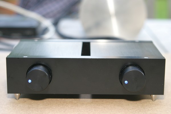

Jerry T. said:Latest update on our Gainclone, i think it's getting a bit out of hand. We've started with this project over a year ago!
Anyway, we're getting there slowly but surely.
Hey, I see Peter Daniel written all over this nice little amp
Chris
PS. I think Peter should consider my vote of a logo call
PD Signature
LOL
Peter Daniel said:This am is actually based on 47Labs, Gaincard. I see Mr Kimura written all over it
Took you guys a while to finish it, but it looks good. What is the finish?
Thanks, we've build 2 now, and they are black anodized.
I still have to redo 4 Power Suplies, because i used the wrong type of aluminium for them. They came back horrible from anodizing.
And yes, Kimura San inspired us!
