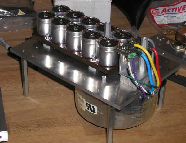

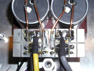

And here's how the bridges are mounted and connected with the rest. The capacitors are Black Gates (as seen in the other thread😉 ). This is the smaller bank, two other banks will be installed next to output devices with thermistors in between. Two standoffs on top will be used to mount front end board.
I always like to use as shortest connections as posible, so you might notice that the bridge is in direct path between transformer and caps. The 1/4" aluminum platform is not only base that supports everything, but also a shield between AC input circuits (not installed yet) and tranformer and the rest of the amp.
You got me curious here.
"Clever layout reduced the number of connections".
What did you take away from 2 AC input and + and - out? Any chance of you sharing the layout (I always end up with something fairly unappealing technically)?

Peter, -are you using thermistors between your cap banks to achieve a CRC filter ? -What rating are they?
I'll be using 2 paralleled CL-60 per rail. I don't know how it'll turn out thou. Star ground is at the bridge.

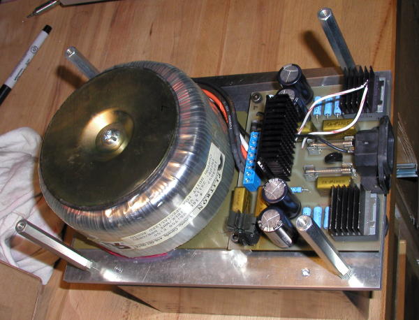

Here's the other side of my PS module. Transformer is 750VA, with primaries in series to reduce the secondary voltage. I'm getting +/- 22 v DC without load now. The schematic for the AC input filtering and switching is here: http://www.diyaudio.com/forums/showthread.php?s=&threadid=3924&highlight=schematic+explanation
I'm using a circuit to eliminate DC component from AC line. It's taken from ML 23.5. Indeed, when I was using it in A75, the tranformers were extremally quiet without a smallest hum. The power is switched through a triac by a togle switch and remotedly by wire using 12V relay. I used two CL-70 thermistors connected in series for inrush protection. It may be overkill, but I'm tired of changing bridges.😉
Transformer is mounted using a damping sheet for isolation from the rest of the chassis. The four standoffs are used to mount bottom panel as well as amp's feet.

say...are the heatsink on the bridges really helping to dissipate...nor is it only for the look?

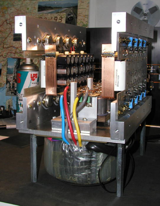

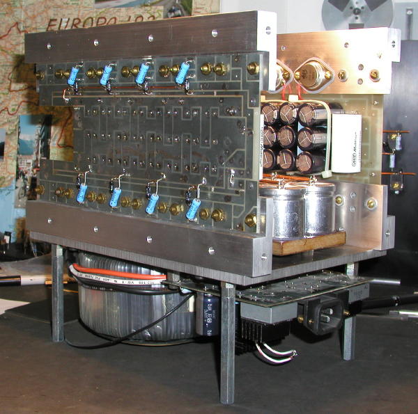

The output modules are added, the only thing left to be done is front end board. It will be mounted on the two standoffs between capacitor banks. I also have to run wires from the bridge to the output devices. The flat pieces of copper is actually Goertz speaker wire. I like to use it for high current applications and here it makes the output bus. It connects rom here with single Caddock 0.1 ohm resistors to binding posts.
That's the side view. The chassis is self supporting and does not depend on panels to hold it together. This is quite convenient and in case of troubleshooting, I can easily remove heatsinks and if necessary, change the output devices. The 4 holes in the transistors bars hold the back panel, the same for the front panel. Four more screws on top for the top panel, the bottom panel and feet are attached to the standoffs. The heatsinks are attached with 8 screws on ea. side.
