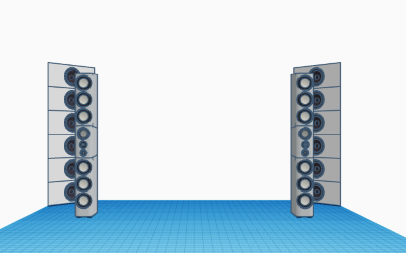

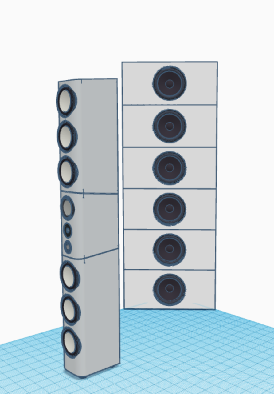

Actually, I think I'll go with six C220s. It might seem insane, but this way, the mid bass also comes close to being room-high. To continue the concept of the singular big wave evenly spreader across the room. Though, what do you think? Should I bend the baffle so the mid woofers will all be aimed straight to the position of the ears, like The Gryphon does with their Kodo system. Though the mid bass frequencies are largely omnidirectional, this will somewhat concentrate all energy to the position of the ears and make the waves of each individual mid woofer arrive at the same time, though, it doesn't cary the concept of making one big flat wave traveling through the room. So, or should I keep the baffle flat to cary through the concept of developing one big flat wave traveling through the room? I do like this idea but might actually be harder to accomplish by mid woofers placed in the room, instead of in the wall like with the subwoofers.
I don't think using multiple small woofers is a good idea. It'll be more expensive and you'll be pushing them below their working range. Woofers start behaving very different below their resonance.
You can force a drivers frequency response quite far, but it does have it's consequences.
Personally I think 1-2 good 10-12" subs per channel will be plenty. Though my needs are different from yours, also my wallet looks different.
If you truly want the lowest distortion, I think motional feedback is the way to go.
RMS Acoustics has published very useful papers on that.
Do you have a source for the scanspeak woofers distortion?

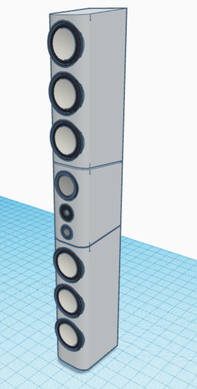

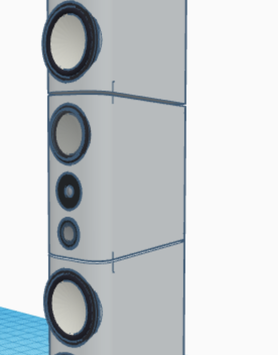

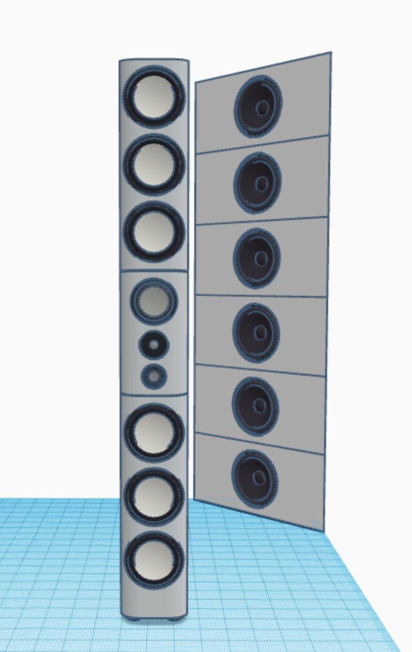

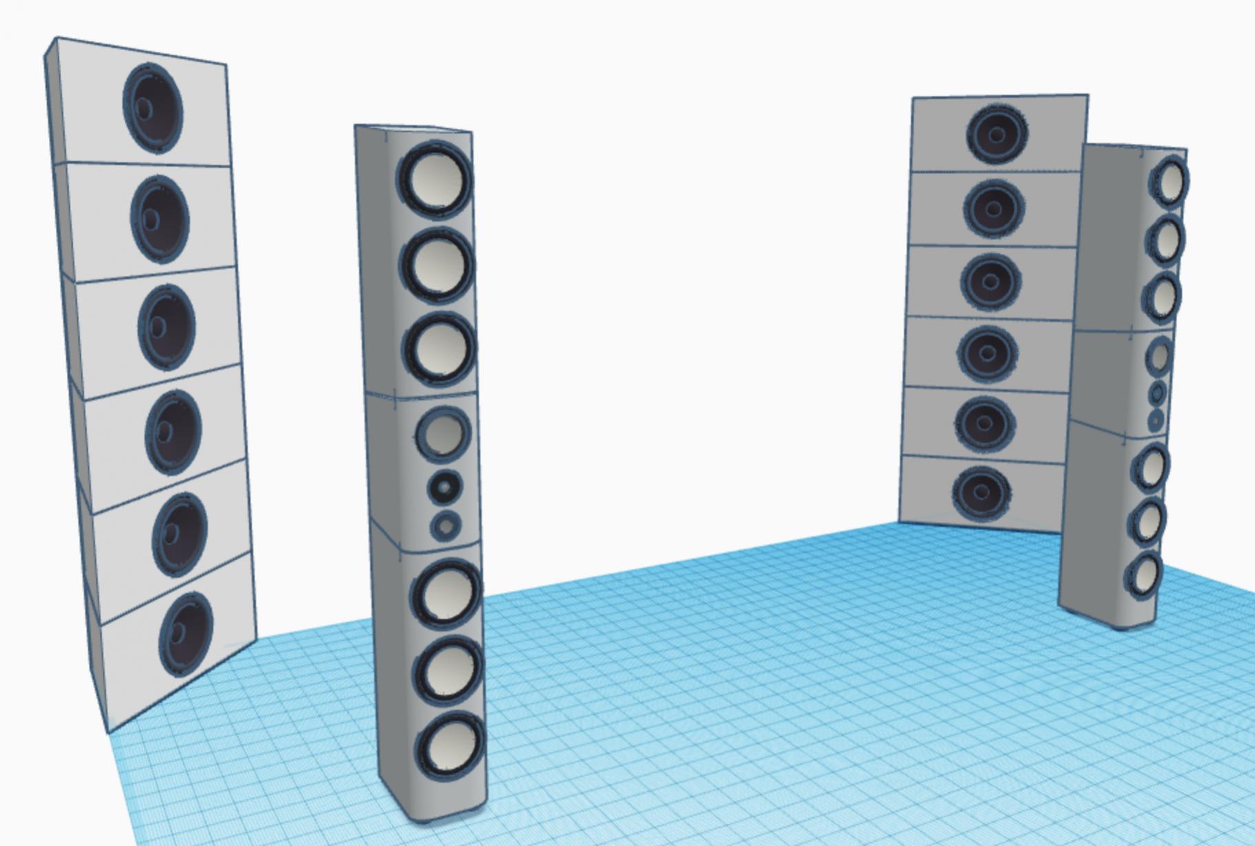

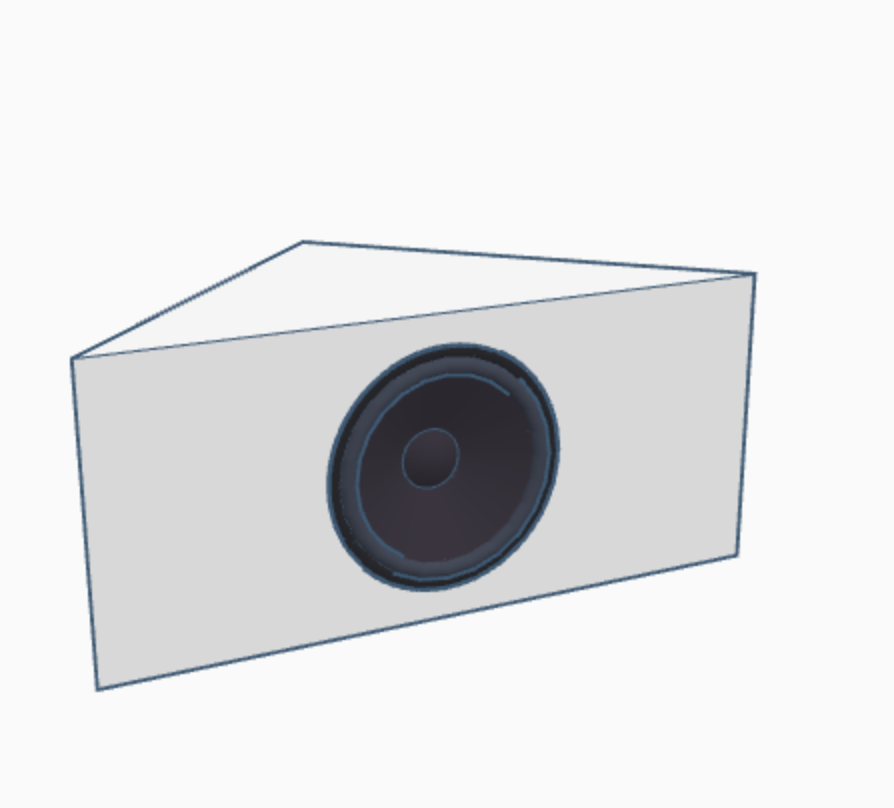

Here are the 3D models. Might I ever build something like this I would probably work a little more on the styling but it's about the concept for now.
The mid-high towers will consist from 3 compartments, with the mid bass in separate enclosures, decoupled. It's quite would probably be made from solid aluminum. The bass towers with the 32Ws in the corners, six on modules in this case. This should be epic if I were to ever build it.

Definitely took some inspiration from those! I also took some inspiration from the The Gryphon Trident II and Kodo, Göbel Epoque Aeon Reference, a bit of the RaidhoTD 4.8, Teilaktiver DIVERSO, Myro Time. Really speakers with many (mid) woofers on a row in a relatively slender cabinet, since these C220s in a sealed box really don't need that much space at all.
By the way. The mid bass cabinets are decoupled and all but I would still like to minimize vibrations. The cabinets will probably be made of aluminum were I ever to actually build this, but I do like the idea of vibration cancelling by placing more woofers in opposite directions. I could do this but this would mean mounting mid woofers on the back of the cabinets. Will this cause time issues, even though bass is largely omnidirectional? Or maybe, would side mounting the woofers be a option? This will eliminate the distance difference in depth between the woofers on the different sides, but will side mounting the mid woofers have much undesirable consequences in the mid bass?
Vivid Audio also uses side mounted woofers up to 300 Hz, and they definitely know what they're doing, and they sound amazing! I can tell.

In case I will have the space a ability to put subs in the corners, which I doubt if I will, I would simply put as many of these ultimate 32W modules as I would be able to afford in the real world.
In case I don't have the ability to use corner-subs, the subs will have to be inside the main towers.

having read your posts I don't think you've seen all subs. I'm doing almost the same project on an alternative way. First, I build with PA woofer. I like the size and want to try it how it sounds as a serious hifi system - if an audiophile-grade sound is attainable or not at all. Listening will tell but fun is fun, right ?
So, mine would be a 3-way active system, stereo of course with following considerations:
- 1 big tall trapezoid (pyramid like) box for the 21" woofer, 1 small box for midranges and 1 very small for the tweeter
- Bass: 1x RCF LF21X451 (check this - lowest 'fs' with a nice freq. curve)
- Midranges: 4x Faital Pro 6FE100
- Tweeter: 1x Aurum Cantus AST25120, alternatively (due to power considerations) 1x Mundorf hifiAMT®29CM1.1-R
Bass has the lowest 'fs' among PA woofers (28Hz) while having a 97dB sensitivity (rather 95 within the box, according to simulations). 2000W.
Midranges are connected 2-2 in series and then these 16 Ohm series branches again in parallel, getting back to 8 Ohms nominal. RMS 100W capability for one such a driver (and this is a real number, no joke) but this way they only get 1/4 power so altogether we're at theoretically ~400W capability for the midrange section. Furthermore, from their base 91dB sensitivity I jump up to ~97dB (around 95 in reality I assume, better is even better).. 🙂 Midrange resonance freq. and impedance peak is below 1st crossover frequency - no drama for the driving amp.
Tweeters are AMT, they sound like ribbons (99.999%) 🙂 but are not prone to wear and don't need to be changed that 'often' like true ribbons. The Aurum Cantus can withstand 100W RMS although that much is not likely to fall onto tweeters. Nevertheless if I go mad it might have a hard time, that's why I'm also considering the Mundorf. The AC has 98dB, the Mundorf 100dB sensitivity and with every 3dB increase 1/2 power is enough to get the same SPL (so for the Mundorf I can have a somewhat lighter amp too). Resonance freq. again below tweeter crossover freq. so again no drama at amp side.
And 3 (stereo: six) monoblocks where I can fine-tune the gain structure of the whole chain. (The 3-way XO will also have gain pots).
I've checked your chosen Accutons, hmm I don't get that "wow" feeling at first sight. They might be excellent but having a look at their datasheet (and then price) I think I'm rather choosing the Faitals and take the risk of less 'bells and whistles' while staying on ground with a way better price point.. while still having a decent midrange section with nice freq. response. Off-axis directivity is excellent too and acceptable even beyond M-T crossover point.
Gains will be matched according to maximum SPL capabilities so most probably the 2kW woofer's amp will be attenuated the most while mid and high section remains almost untouched I think.. we'll see. But that greater gain reduction at woofer side doesn't mean it's wrong, it actually means I'll have some great reserves when playing modern music or throw in a movie.
This whole concept began in my head while listening to my favourite music in Foobar: I checked tons of tracks and watched carefully at the Spectrum Analyzer which low frequencies I still need to cover (flat) if I want those tracks sound like they were intended to. I came to the conclusion I'm going with this PA woofer in a big vented box (450-500L), a tall pyramid box with no parallel walls, roof chopped off of course. Midrange and tweeter will have separate own boxes, all voice coils aligned vertically (with woofer too) and these boxes will also have a separate suspension to avoid woofer resonances getting into them directly via the box walls.
I'd recommend you to check you musical taste, it can help a lot defining what you need and what you don't. Surprisingly I saw some of my slow paced relaxing tracks like Vangelis, Hans Zimmer movie tracks, Jean Michel Jarre, Madonna... going deeper sometimes than house/techno/minimal and stuff like that. It was a great and very useful discovery.
Finally, I wanted to keep most of the male voice coming from the midranges (instead of the woofer) so I chose a crossover freq. of 125Hz (reference: Mark Knopfler, Chris Rea). For the tweeter , max. power numbers are stated at the recommended XO frequencies and for both I'll be above them, at 2kHz, with 24dB/oct. slope (4th order Linkwitz-Riley) so I think this way factory numbers will be attainable without tweeter damage (else I would take them with a grain of salt but this way I think I'm on the safe side.. with higher XO freq. and steeper slope).
