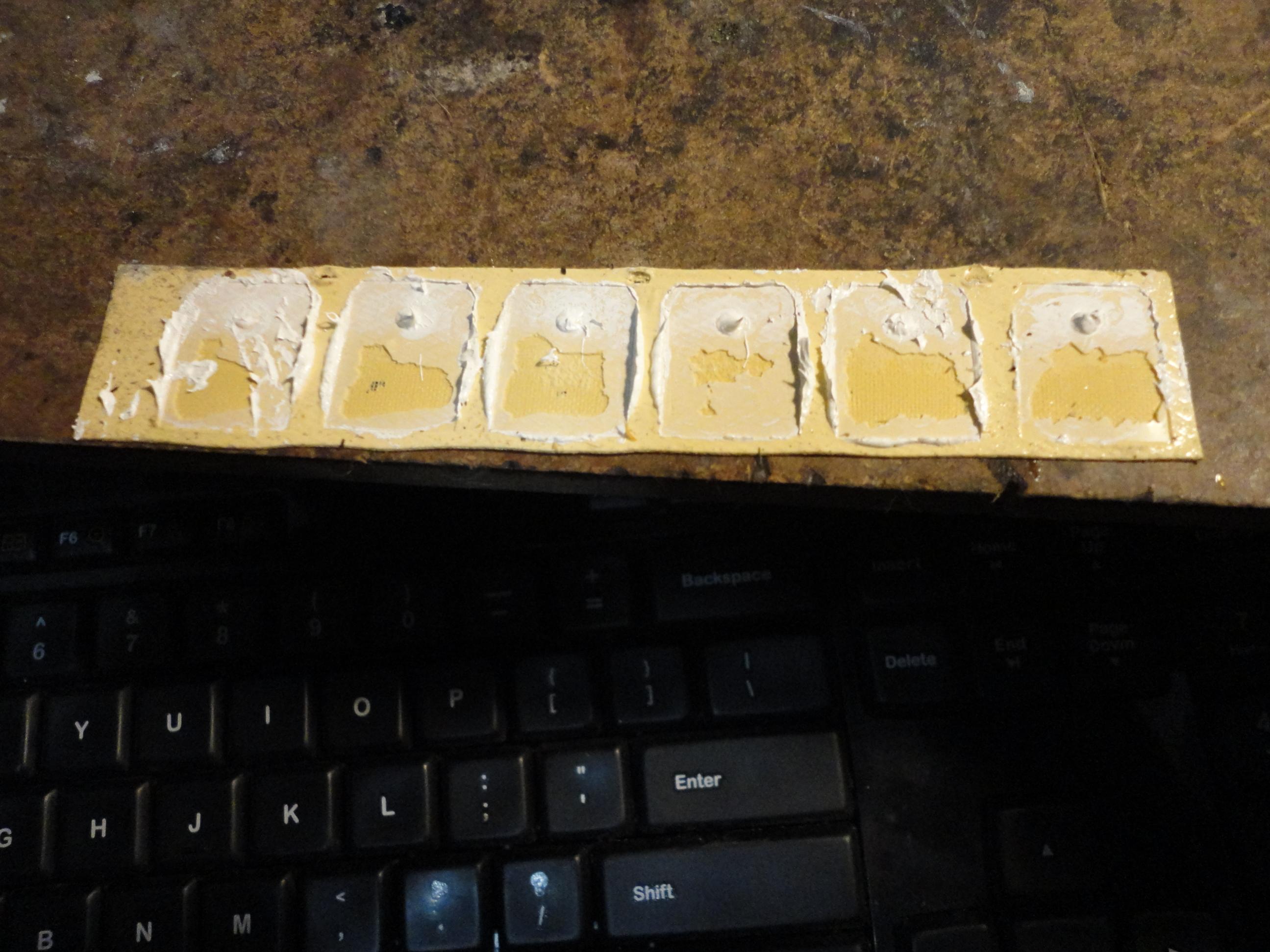

I don't have an answer but Bergquist makes similar insulators.
You'll need to measure the uncompressed thickness and whether it has a fiberglass reinforcement layer or not (it doesn't appear to have a Kapton core).
There will be different grades, the most conductive will cost more.
