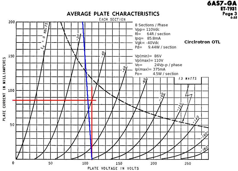

CarlyBoy said:Miles, how low powered you ask? Say 30W.
I've no experience with the 6C33C. Have done enough reading to be tentative, but also trying to keep an open mind. I'd rather stay with the 6AS7...
I've done some very preliminary design work on this since I'd like to do a OTL some day. 6AS7s are a good choice, and you can get 30W with eight sections per phase, and stick to the conservative side of the ratings. Here's a loadline for this.
