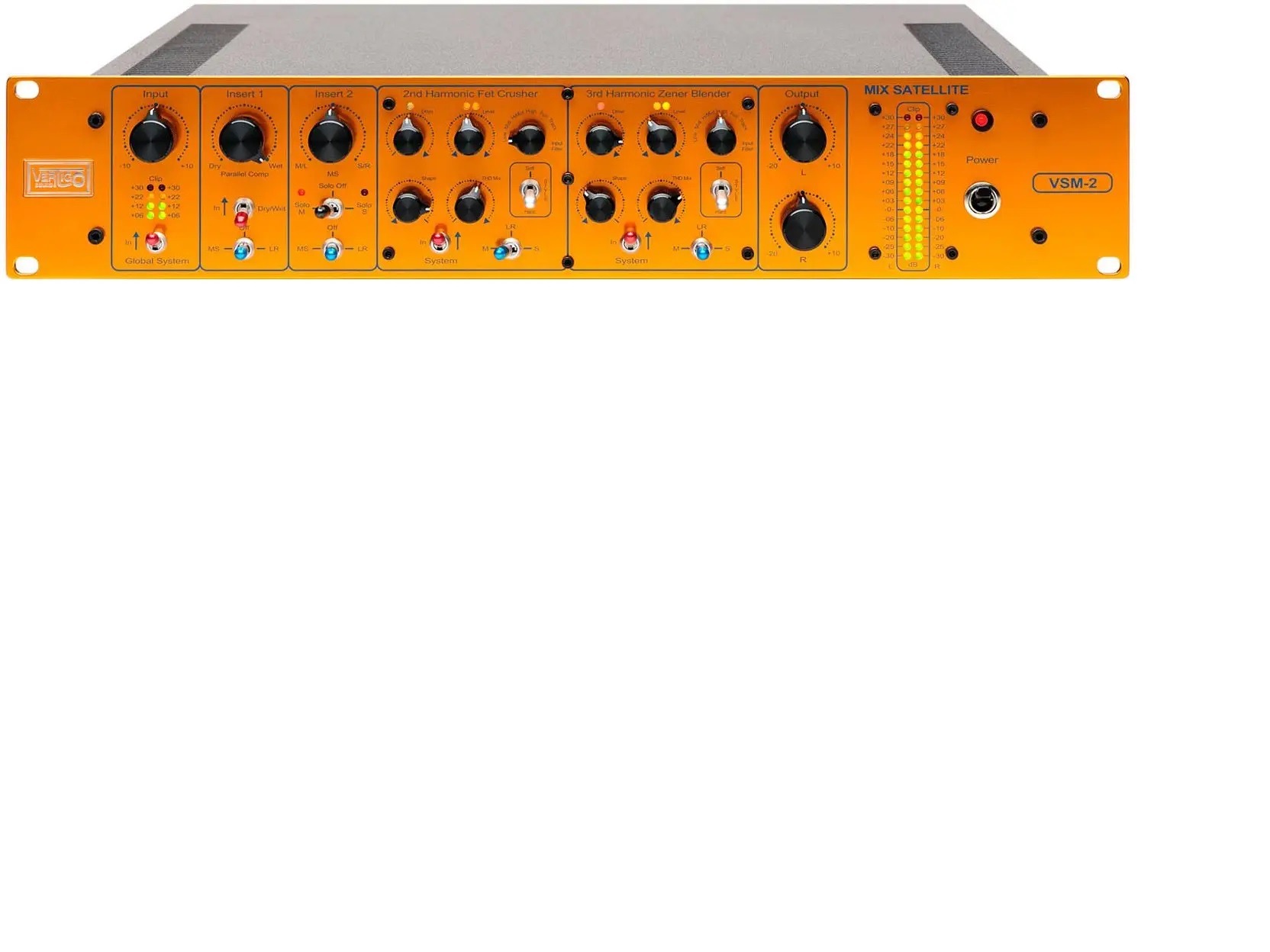

I ran across this product on another thread today. It generates 2nd and or 3rd harmonics. Maybe a schematic is out there somewhere. The "2nd harmonic Fet Crusher" and "3rd Harmonic Zener Blender" give some clues. https://vintageking.com/vertigo-sound-vsm-2-mix-satellite-mk2-full-version
