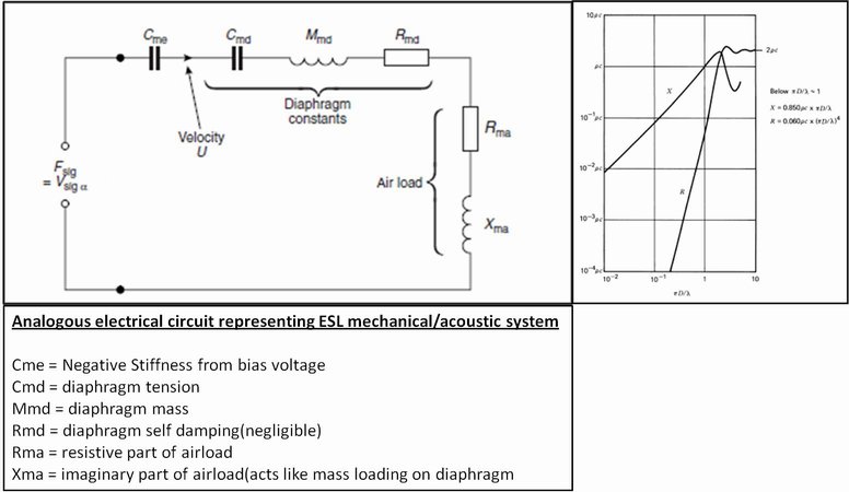

why does a film of 22 micron does not have lower spl then a 6 micron ? is this because both a lighter then the air it moves ?
That is essentially it.
When modeling an ESL as an electro-acoustic circuit the diaphragm behaves like a mass(inductor Mmd).
The air is a bit more complicated, behaving like a resistor at high frequencies(Rma), and a mass(inductor Xma) at lower freqencies.
The air and diaphragm are in series in the model, and the impedance of the air components (Rma & Xma) dominates the current thru the circuit for all but the highest frequencies where the mass of the diaphragm (Mmd) begins to exceed that of the air resistance(Rma)
There is a simple formula to calculate when this roll off due to diaphragm mass starts.
Details at link below, along with some measurements compared to theory.
http://www.diyaudio.com/forums/plan...tatic-speakers-microphones-5.html#post3427260
As Calvin mentioned, if you are measuring response flat to 20Khz with heavier films this is due to some type of resonant boosting. It is most likely electrical resonance from the transformer leakage inductance and ESL capacitance. It could also be partially acoustic resonance from the cavity formed between the stators, especially if % open area is not 50% or greater.
