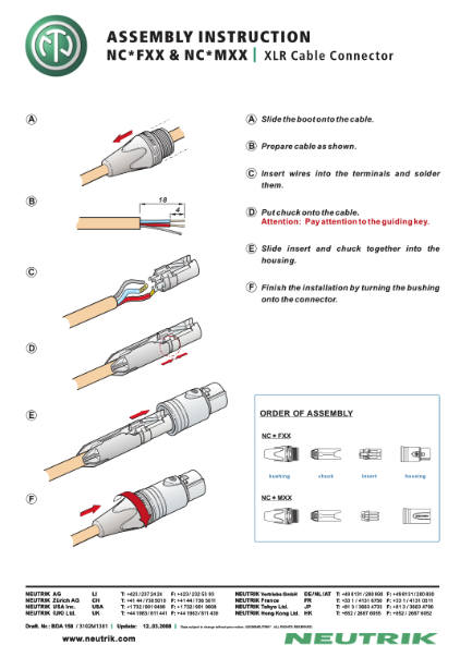

This sketch is for fixed instal where cable are connected one time and never used again for their entire life span. Which should be the case in some studio's part or home environnement.
If you use them constantly and under rough conditions they'll break soon enough because someone will pull them by the wire/cable instead of connector.
If you want to have a bit longuer lifespan, don't cut at 18mm but almost twice that length and make an S shape with them ( folding on themself): it'll give a bit margin when someone pull the cable and do not put constraints on the solder joints on the connector.
Do the same for the shielding and use capillarity* to soak solder on the last section of the S shaped shield, leaving the knee and last part solder free ( allowing free movement).
I learned this when i worked into a sound engineering school where students had access to sessions in our studios on daily basis 18 hours a day.
If cables where done as in the sketch lifespan was at most some weeks ( 3 to 5). Done with the S way they usually had a year before they needed to be serviced.
It's good approach for live use too.
*: when twisting the shield strands together doing the S shape don't apply to much force. Once done put your soldering iron on the last section for longuer time that you would normaly: it'll heat strands way deeper and will help with capillarity: solder will be soaked by itself into the twisted braid.

As usual, I appreciate your descriptions of what happens in the professional world, and having appreciated it this time, I just want to add that the sketch is taken from a Neutrik PDF Assembly Instruction - XLR XX Series which I use as a reference when making my own DIY (XLR) cables.
However, Neutrik connectors use a knurled chuck strain relief for a given cable diameter that makes it impossible for soldered or crimped wires to be torn out of the connector even if systematically pulled or twisted hard in a professional (careless) environment.
And, just as said, it is obvious that an amateur would never do this at home with his own cable/system.
Anyway, even if he did it would cause virtually no damage to the Neutrik connector wiring.

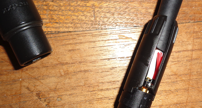

Impossible to torn out connector on Neutrik's XLR thanks to the knurled chuck strain? Too bad we can't bet on this! 🙂
Let me see if i have pictures of some in old hardrive, i had documented this in our locker room as students did not understood why we checked cable ( and mics and all gear in fact... you wouldn't believe how people do not care when they did not spend money to buy things...) after each sessions and applyed fees if they were 'destroyed'. We had to have visual example not to discuss for hours. 🙂
I can garantee you there is nothing impossible and why we did our cable the way i explained. The Neutrik's system is clever and give a increased level of protection but in no way it's bulletproof as it rely on the wire jacket material and all are not very good quality or at least supposed to be exposed to such constraints.in particular when it's repeated.
