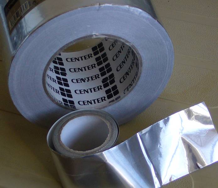

Aluminum tape is used for connection of the panels of insulation under roof
Edit : oups, sorry MadHattter, I realise the aluminum is not really 100% transparent...

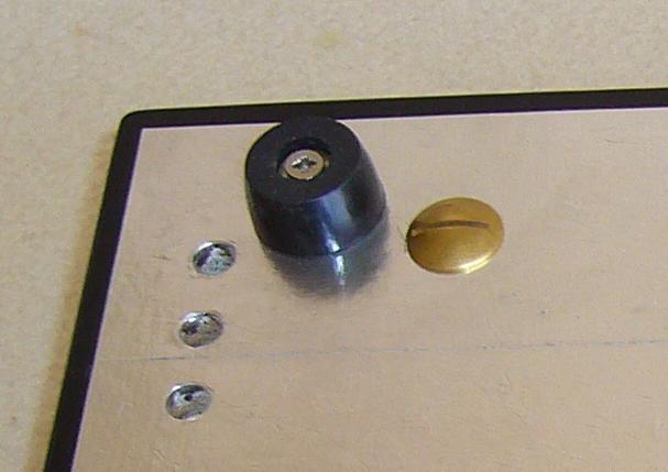

@AndrewT : by including silver plated cables, under an aluminum "patch". And also, at bottom, plated by the brass screw with broad head of the main ground... the same into the amp.

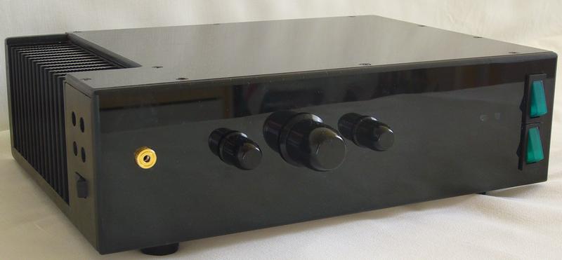

yes it is brittle... on my amp, only the top is full Plexiglas as there is no stress there.
But at front, the mechanical parts (2 switches and 1 pot) are fixed on the wood, the Plexi is just there for eye-candy and glued with double face tapes on the wood part.
Of course it can't be let transparent, so the verso is painted in black.
I like it but it is delicate, nobody but me may touch it 🙂
