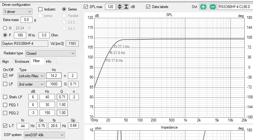

I don't know if this helps you model the effects, but you can apply a LT (and other basic HP/LP slopes) in VituixCAD's enclosure tool:
e.g. here's a Dayton RSS390HF in a 90L enclosure with an LT to net a < 30Hz F3.
Also beneficial is excursion modeling (not shown). The 180w level is where xmax is reached due to LT being applied (14.5mm @ 21Hz).
A number of DSP platforms are supported, so you can export the parameters of your filter(s).
