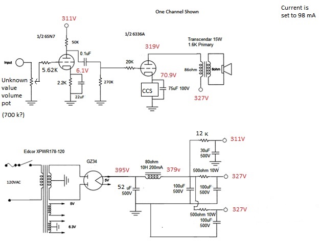

As a side note, that I might make another thread about is, my 6336a SET amp. I've noticed when comparing it to my other amps the mid-range seems muffled and I'm wondering if it's because of the driver stage (it's only using half of a 6SL7) or maybe that's just the sound of the 6336a? I'm wondering if I should mod it or just move onto something else.

6336a midrange sounds poor? did you do some measurements? I would not blame 6SL7, but it is also not really a driver.
I did some bench tests on it a while ago, it measured well (I want to say about 1.25% @ 1 watt) but, you can definitely notice that part of the mid-range is veiled / muddled when A/B listening with other amps, even my Father picked up on it which surprised me since he's not into audio. (I didn't build this amp I picked it up second hand to play with, I thought the 6336a seemed interesting)

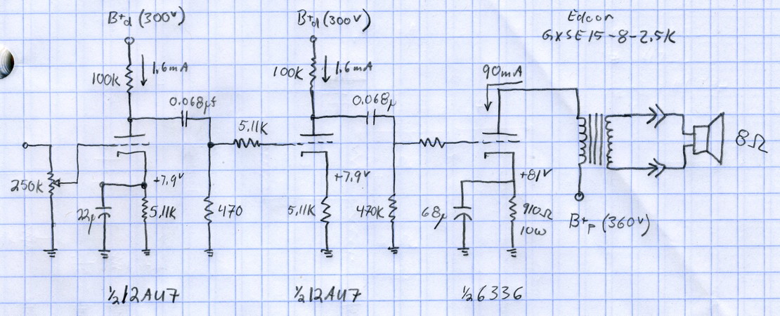

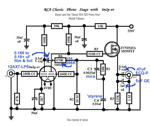

I was wondering if I should try implementing this circuit using 12AU7's from cascadetubes.com or do you think the method using the ZVN0545A would be more effective?
I wince anytime a 12AU7 section is used as a common cathode voltage amplifier. That triode is non-linear and (IMO) should serve only in the cathode follower or "concertina" phase splitter roles.
DC coupling the little FET to a tube's plate is a "no brainer". Among other things, heater power and heater to cathode potential worries are absent. The only "gotcha" is power on transients and that's dealt with by adding a protective 12 V. Zener diode between gate and source.
Even wimpy types, like the 6SL7, 12AX7, and EF86, have no problems driving the tiny capacitances of the ZVN0545A.
While it is simplistic, thinking of FETs as heaterless pentodes is (IMO) not a bad idea. OTOH, current controlled, low impedance, BJTs in the signal path give me the "hebe jeebies".
That muddied sound is likely poor transient response. The frequency response might be good. The THD might be good too. But without excellent transient response, your amp will sound muddy. It is not easy to measure transient response. You just have to design with it in mind.
I am looking at your schematic and I see a 20kOhm gridstopper. This seems to be far too big. I would try 1kOhm unless someone more experienced with 6336a says otherwise.
You might lose some lower frequencies by dropping the whopper value of that grid stopper, but your cathode by-pass cap on the 6SL7 looks too small as well. Make it at least 100uF. This should help you get decent bass response too.
These are quick fixes. My next suggestion would be to follow Eli Duttman's advise. What he proposes will take almost no space and is very inexpensive.
If you still have poor transient response, I am afraid to say it is probably your power supply.
Your power supply is CLCRC. I never build this anymore. ever. I like to do LCLC or LC<regulator> for pre-amps and smaller stuff.
You need that first choke to work as an energy reservoir but putting a cap in front of it defeats that functionality. Of course you will lose a lot of B+ by taking it out, so you're kind of stuck with that now. Sorry for this... maybe your amp will run well at a lower B+ though. You should simulate it first perhaps.
When troubleshooting this amp a few years ago those 20k ohm gridstoppers were actually swapped out for a 1.8k ohm ones, which corrected some other issues it was having. I forgot to update the diagram.
You have won me over, I would like to try the ZVN0545A's but I don't have any experience with them, if it's not too much to ask could you make a circuit diagram of them in my amp so I do it correctly?
