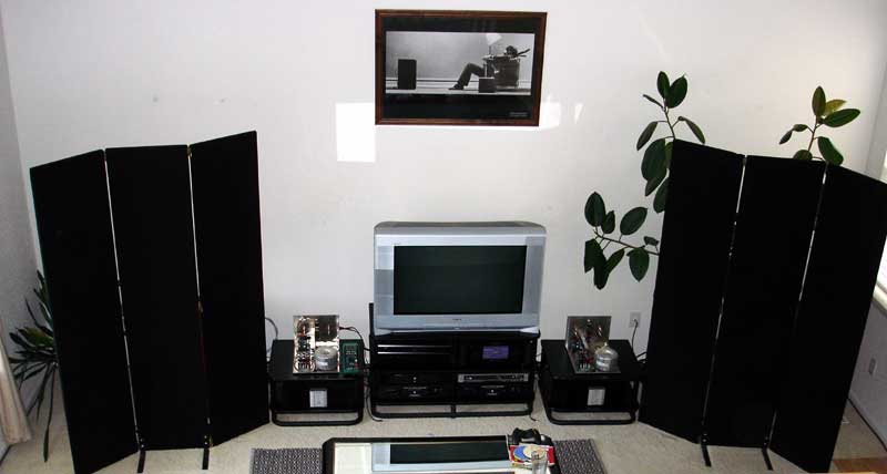

here is the test setup so everyone knows what im using and what im listening to...
amps: rotel b-1070 (biamped) compared to mono ucd-400's
speakers: magnepan tympani 1D's
subwoofers: dual velodyne DD-18's
source: denon dvd-3910
processor/preamp: rotel SP-1098
power: dual furman Elite-15PF's
power cords: audioquest NRG-2's
analog interconnects: audioquest jaguar 36v dbs
digital interconnects: audioquest VDM-5 dbs
speaker cables (bass): audioquest volcano 72v dbs
speaker cables (treble): audioquest mont blanc 36v dbs
sub cables: synergistic research res. ref. active

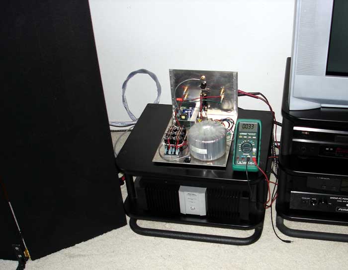

the actual amp setup. before anyone says anything...
1) yes, there is a lot of hot glue holding things in place. its just a temporary setup, and hot glue isnt anywhere where it would get hot and melt.
2) yes, the transformer is just sitting there, not mounted. i didnt have any mounting plates, it seems i lost the originals.
3) the heatsink gets a little warm, but even with the speakers as loud as i want to go, they never get uncomfortable, or close to hot.

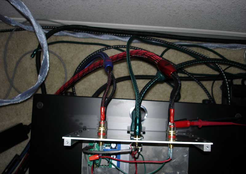

and finally, the backside. i'd rather not turn this into a discussion about cables, so if that is your intent, open a new thread please. i was a dealer and got a lot of perks. if it was up to me to BUY all these cables, i probably wouldnt have gotten the exact same ones.
