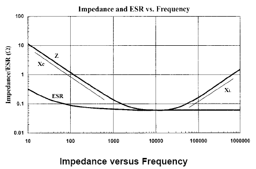

Re: Re: Re: Bypass caps- No
If you have ever seen a datasheet for a capacitor you would have noted that ESR is always plotted against frequency. If my statement were wrong the plot would be a straight line. Here is what ESR looks like for a Blaqck Gate N:
Definition of ESR: ESR is the sum of in-phase AC resistance. It includes resistance of the dielectric, plate material, electrolytic solution, and terminal leads at a particular frequency. ESR acts like a resistor in series with a capacitor (thus the name Equivalent Series Resistance). This resister can cause circuits to fail that look just fine on paper and is often the failure mode of capacitors.
To charge the dielectric material current needs to flow down the leads, through the lead plate junction, through the plates themselves - and even through the dielectric material. The dielectric losses can be thought of as friction of aligning dipoles and thus appear as an increase of measured ESR as frequency increases.
Now, if you're arguing semantics with me, that's another thing. While ESR is technically just the resistive portion of the inductive impedance of a capacitor, it's common to refer to the whole as ESR.
Given this, I call into question your motivation for coming across as a horse's rear quarter.
classd4sure said:
"Low ESR means low impedance at high frequencies. "
You couldn't be more wrong.
ESR is "resistance" and impedance is another matter.
ESR will stay the same across all frequencies, it's a constant in the equation.

I'll first say that wasn't the best graph to make your point with. Looks like more of an add to me, but you brought it to the table, so we may as well have a look at it. It looks to me like what they're showing on the Y axis is "impedance" and not ESR. I fail to see how that can be arguing symantics when it's the whole poit of this discussion-what snubbers compensate for-what's actually responsible for the rise in the response curve?
You're arguing it's ESR, I said ESL. So there's no symantics there.
Actually, it say's "Impedance. E.R.S". Can you tell me what ERS is? It doesn't appear in the legend? To me, it would appear as a marketing add for their caps wired in "super E" configuration, and so dont' mind me if I choose to dismiss the technical validity of it, especially when they fail to label the axis appropriatly, from what I can see.
Maybe I was wrong about something, I did say ESR was constant across all frequencies..... guess I over simplified things. So we'll agree it varies with frequency. Let's then look at how, shall we?

Now, the changes in the dielectric you quoted are said to increase ESR with frequency, that doesn't mean that the curve rises, it just falls less rapidly (levels off). So as I said already, what you're seeing when the impedance curve rises is the ESL which is what snubbers compensate for.
Now for a graph that's a bit less of an add, and perhaps a little bit more scientific, from that very same paper.
Given this, I call into question your motivation for coming across as a horse's rear quarter.![]()
It looks to me like what they're showing on the Y axis is "impedance" and not ESR. I fail to see how that can be arguing semantics when it's the whole point of this discussion-what snubbers compensate for-what's actually responsible for the rise in the response curve-non linear response "at high frequency" as you said?
You're arguing it's ESR, I said ESL. So there's no semantics there, is there?
Actually, it say's "Impedance. E.R.S" on the axis. Can you tell me what ERS is? It doesn't appear in the legend? Where does it even show ESR Vs ESL? Poor choice indeed.
C'mon Mac, do some real homework, or don't be so quick to dismiss that of those who do

classd4sure said:Maybe I was wrong about something, I did say ESR was constant across all frequencies..... guess I over simplified things. So we'll agree it varies with frequency.
Yes Chris, you were wrong.
For the benefit of others I have updated the graph to better illustrate my point that ESR does in fact vary with frequency. The graph now shown was randomly pulled from a CDE datasheet.
Whatever you say mac. I'm glad you've taken my hint to research some CDE papers and gotten away form the marketting adds.
It however illustrates my point, and not yours. Unless I'm blind? Maybe you can edit that and show me where ESR is "rising" with frequency as you said it does.
