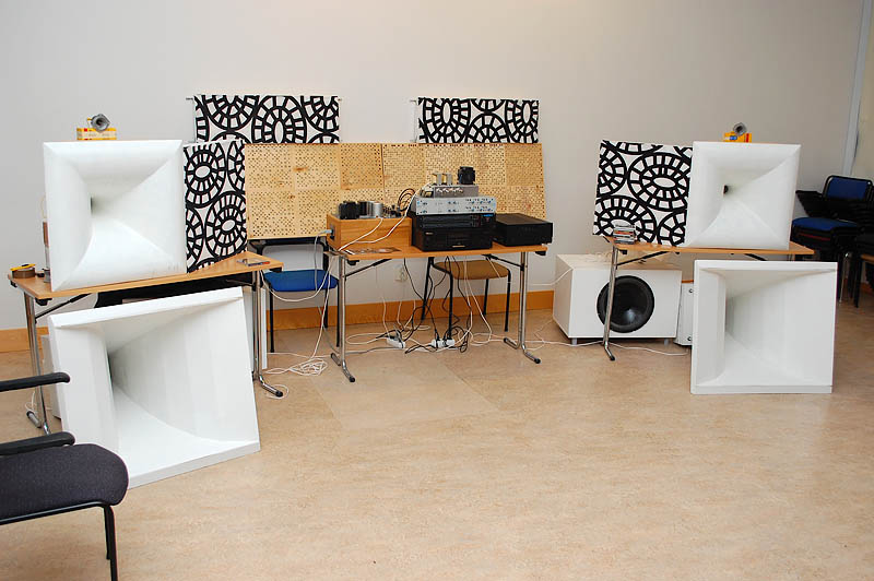

As sort of a Grande Finale, I brought my horn system to the DIY Fair in Uppsala yesterday. The LF horns were cut in pieces and thrashed weeks ago so I used my old closed cabs with 15" woofers up to 130Hz.
It took quite a while before we (me and two friends) got the system to sound even half-decent but a pair of horn tweeters donated by Petter (Mr Multicell) saved the day.
I used my 12B4A CF amps from midbass and up and a borrowed Teac SS amp for the woofers. The Teac died an awful death at the end of the day during a Yello cranking session...
I take the liberty of borrowing a picture taken by one of the visitors:

Thanks!
Sorry, this is the only picture taken so far, showing the left channel in a very temporary setup. I can share some info though:
40-150Hz: 90L Onken-tuned boxes with Eminence Beta 10A woofers
150-800Hz: 140Hz Tractrix (slightly truncated) with cheap 8" pro drivers
800-5000Hz: DIY multicell horns (Fc 285Hz 15 cells) with 2" P.Audio drivers
5k-~15kHz: DIY fibreglass/resin LeCleach horns, see the LeCleach horn thread (page ~90 for details). Eminence PSD2002 drivers.
Unfortunately my active XO gave up the ghost by going into violent oscillations, almost ruining both mid drivers and my underwear, so for now I´m using first order passive XO all the way through. Might build a better active XO someday or refine the passive ones, or try both.
The picture is taken in my livingroom but the plan is to build a dedicated room for the heavy hifi in another part of the house. Must tear down a couple of walls to achieve a decent sized rectangular room but hey, I´m a single man so why not? The cat won´t complain...
To be honest I´ll probably end up with a set of quite large speakers in the livingroom too even if I have a "man cave". Been thinking about a mono corner horn rig in my bedroom, too...

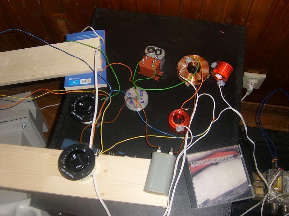

Pano: Thanks! The crossovers might look worse than they are, second order 3way with some zobel and notch filters involved. The woofers will get their own amps and active crossovers later on. Yesterday a friend showed up with some equipment to help me with the crossover, after a few hours at 50% of the components were replaced with different values and the summed output was starting to resemble a flat line (except for above 4khz due to the HF drivers I´m using, they will be replaced later on).
