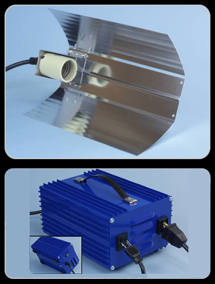

would this light source be ok?
its uses a metal halide bulb and has a reflector back.
and is 35,000 lumens 400 watt kit.
I am using a 10.4 inch sharp screen
a 12 X 12 fresnel
and a
Xerox/Fuji 325mm Focal Length Multi-Element Lens
would this work ok?
The light and ballast would probably be okay, but I doubt if you can get that reflector to work properly. You will probably get a bright, but uneven and blurry image with it.
If you want to use a parabolic reflector, it has to deliver a very uniform set of rays. This reflector won't do that: You will get a hot spot in the center from the direct light, and lots of rays that won't even hit the objective lens. A good reflector design would be parabolic in both dimensions, deliver a perfectly parallel beam of light (not spreading over distance), have some means of blocking the direct light from the bulb that is off-axis, and have a method of attenuating the on-axis direct light so it is only as bright as the reflected light. It would also have to be as wide as your LCD diagonal.
You could use the bulb and ballast, and replace the reflector with a spherical reflector and a condensor lens. Or you could just buy a Ushio UHI-S400DD from atlantalightbulbs.com and a 400 watt HPS ballast from goodmart.com. This is the best bulb I have found in terms of color temp and CRI, and the cheapest ballast that can run it.

The Ushio bulb I mentioned is special (and not cheap at $37.95): It is an HPS retrofit, which means it works with an HPS ballast, capacitor, and ignitor. It is designed to replace orange HPS bulbs in an existing fixture. (I have read that it can also be used with a standard 400W MH ballast.) So they paid a lot of attention to the quality of the light. It is 5200 deg K and CRI=85 (or maybe 90). This is better than most MH bulbs. It also has a pretty small physical profile, which makes it easier to use in a projector with a spherical reflector. Here is a link:
http://www.atlantalightbulbs.com/ecart/10Expand.asp?ProductCode=UHI-S400DDUSHIO
You run it with an S51 HPS ballast. goodmart has several, but this one is cheapest ($60.67), and includes brackets, cap, and ignitor: (it weighs about a ton 😀 )
http://www.goodmart.com/products/243289.htm
Or you can try it with a $53.34 MH ballast (at your own risk):
http://www.goodmart.com/products/433838.htm
goodmart will ship from Orange, CA very quickly, but atlantalightbulbs may take a while. Somebody wrote that they don't stock these bulbs and have to order them (ie. 10 days)
