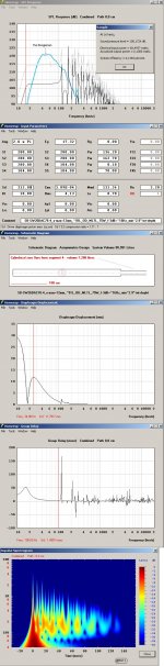

Here is my catch 22. One of my systems is in a room where I have zero flexibility in sub placement. The only "conventional" location is below and to the left of the left speaker. This of course causes horrible response problems by being just about out of phase with the right speaker in the middle of the crossover. Going to much steeper electronic crossovers, 6 order maybe, could solve a big part of it, but that requires abandoning the good old Denon AVR I am using and having a giant stack of amps again.
Looking for ideas. One is if there was a relatively shallow sub of decent quality I could build a box about the depth of the TV and hang it above the TV on the wall. About a 3 x 4 foot shallow box. I also thought about putting it in the attic and ducting it down.
Anyone do either of these things? Know a decent shallow driver?

A candidate is the Hi Vi SP10. If I stick the motor through the rear ( flush ) then I can do a 6 inch deep box, and still do a grill cloth so it won't be too ugly.
Any experience with this driver? I can't tell if the VC is vented through the magnet. That would mess up my idea. Not terribly happy with the shape of the response curve. It looks like it was assumed to be a tiny car box.
The Dayton RSS265 may work and as I just happen to have one sitting around, maybe.
Many more hours staring at numbers. Seas L26ROY, Scan Speak 26W/4558 and Peerless 835017 All are thin enough. I may even pocket the wall to make it a bit thinner with a grill cloth. I have had such good luck with the Peerless 830500, I may just stick in their camp. Then again, I have used many a Seas driver.

After much contemplation, I am going to mock something up with the Dayton RS I have and see how it integrates. Not in love with it, but it may tell me what I want. Looks like a 70L box will fit just fine.

I saw that one. Clever idea. It is thinner even with a grill that covers it, but it did not look very good in the model. Both the Dayton RS and the Peerless have a bit wider and flatter response. This app needs to reach up to 100. So the typical "hump" response that works fine for a sub 30 to 60 does not do well 30 to 100.
