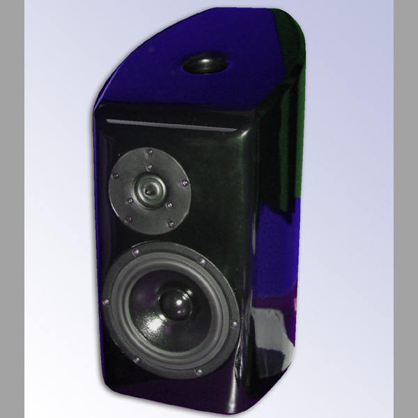

Well, during the construction of my last pair of speakers, which use 5 layers of 4mm plywood over a rigid framework, i tested the speakers out with 2 layers to see what they sounded like, just because the boxes were totally covered with wood. There was a very strong resonance at about 700hz that made some tracks unlistenable. The sound was generally a bit loose and boomy, and i wasnt very impressed. From what i heard id say that 2 layers of 4mm ply simply arnt enough.
Certainly, once id got all 5 layers on the sound improved beyond all recognition and the cabinets became much more inert.
However, these cabinets were glued together with vast amounts of ordinary PVA white glue, I can imagine the adhesive has a major effect on how the layers interact with each other, so using an epoxy may have sonic benefits.
The (nearly) finished article- still need polishing and waxing 😀
(weird reflection on front corner is my fone on the table, not a big dent!)

There are two basic ways of building the cabinet, first build the internal frame work and apply successive thin sheets of mdf or ply to build up the the laminate thickness needed.
The second way is to laminate the curved sides up first and the build the rest of the speaker inside them, I gave some pictures of this process in thread 30855 on a previous pair of speakers.
The attached image is of one of the side panels for my new pair of speakers being laminated up in a vaccum bag. Panel is 4 layers of 4 mm birch ply.
