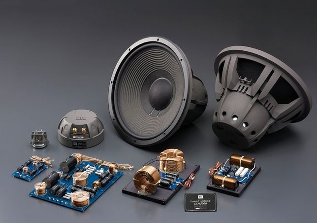

As a case in point, take the following two JBL Woofers (respectively used in two of their current flagship loudspeaker systems, the DD65000 and DD67000).
They are physically very similar (i.e. they share the same fundamental parameters Sd, Mms and the same magnetic motor, hence (BL)2/Re), but they use different suspensions.
Their T/S parameters are:
Woofer 1) Fs = 18 Hz, VAS = 555 L, Qts = 0.20
Woofer 2) Fs = 29 Hz, VAS = 230 L, Qts = 0.30
Do they look different enough to you?
Now go and model both in the exact same bass-reflex box (Vb = 130 L, Fb = 36 Hz)...
Surprised? ;-)
Marco
Very interesting, Marco. :cool:
The woofers behave much the same if my rough and ready maths is correct! :D
But this is not surprising with reflex woofers, where the electrical motor dominates variations in mechanical suspension and mass by a 10:1 ratio at least.

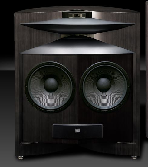

In fact you can SEE that the motors are huge! I enclose my usual superlative images of the JBL DD65000 and DD67000 motor components, along with the enclosure. I do wish people put as much effort into posting as I do. We'd move along much quicker. :rolleyes:
American speakers never fail to amaze me. Does everybody have rooms like barns? :D
