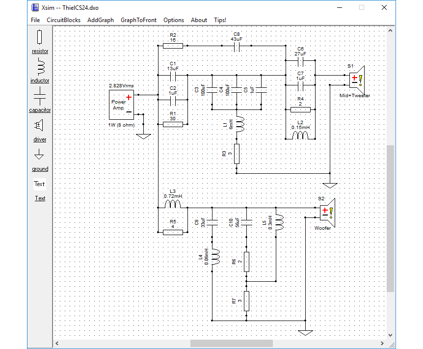

Thiel CS2.4 xover schematics
I am not sure if this is the right place to post so it's up to the moderator.
This schematic is based on the following link. Since the picture has been posted, so I don't think there will be any IP infringement.
https://www1.picturepush.com/photo/a/16092231/1024/Thiel-CS-2.4/CS-2.4-SE-final.png
Since the Thiel CS2.4 uses proprietary drivers so cloning is probably not possible so this is more or less a FYI only.
There are commercial coaxial drivers so it's possible you could use this as a guideline to design a time-phase coherent speakers.

Upgraded the internal wirering with Supra Ply 3.4/s cable's and also grounded the coax crossover backside, coax and woofer frames, crossovers are placed on the side wall's to gain more distance between them and shorter wirering, low mid and high details are improved and got more air overall, bass is clearly tighter :)
The diameter of the Supra Ply 3.4/S cable outer sheath is 8 mm, I have removed the plastic tube that contained the coax wire and the existing holes are then drilled to 8.5 mm with an angle screwdriver, where the cable enters the coax chamber I glued it with a PU TIX Express from Bostik, first I have the cable extended further then glued and then retracted the cable thru the hole again so that the hole itself is also provided with glue, immediately afterwards I sprayed some water with a plant spray to accelerate the drying process, later I tested the closure by pressing the passive woofer with a good result, totally no movement at the coax, the remaining holes are also drilled to 8.5mm so that the wires are supported there too, this time without glue.
The Ply 3.4 / S cable has two 3,4mm2 (OFC) cores, these cores are far too thick to fit into the holes of the coax and woofer terminals, these are soldered neatly direct on the plus and min terminals, the terminal supports of the coax and the woofer are attached to the units with a bolt, the earthed wires are secured to them so the frames are also grounded.
I have placed the gold plated earth terminal airtight through a 3mm hole between the two +/- connections, at the rear is a thin gold plated solder plate fixed to the m3 bolt.
