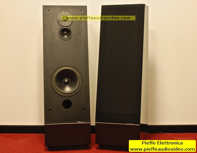

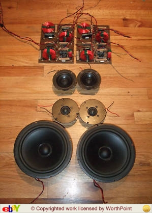

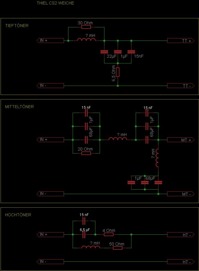

Thiel CS-2 (CS2) - Schematic for Crossover Network wanted

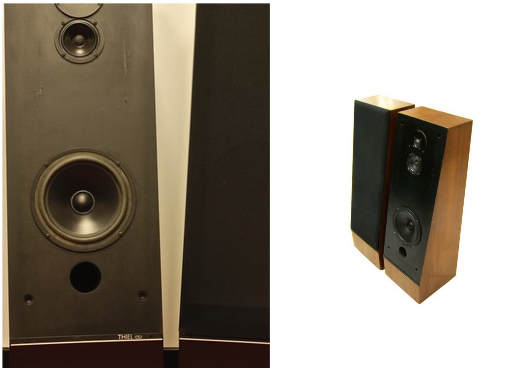

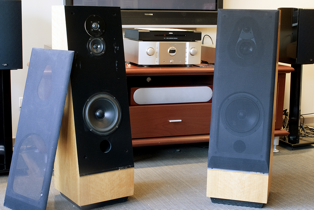

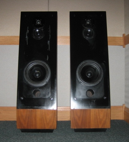

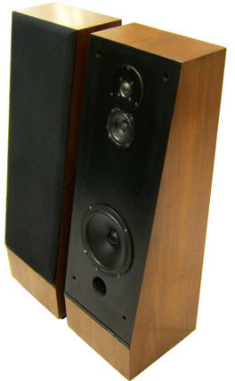

Who can post this schematic?
Perhaps one of the members know also, which driver brands and models are inuse in this phase linear loudspeaker ?
Please do not confuse with the Thiel model "CS2.1" (CS 2.1)

Very special is the fabric-covered frame, as you will see at the third image by post #1. There are no possibilities of inteferences and unwanted reflections in the mid-high frequency area.

Therefore again the question regarded the schematic diagram.
Also images of the crossover network are helpful.
A friend of me want to know the quality standart from the crossover network of his CS2 device without dismanteling the cabinet.
Thank you very much for your help.

It is not the fabric cover that is special. What is special is the curvature of the front plate, designed to reduce diffraction.

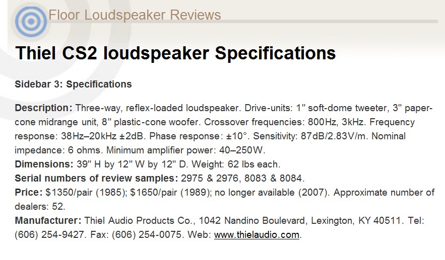

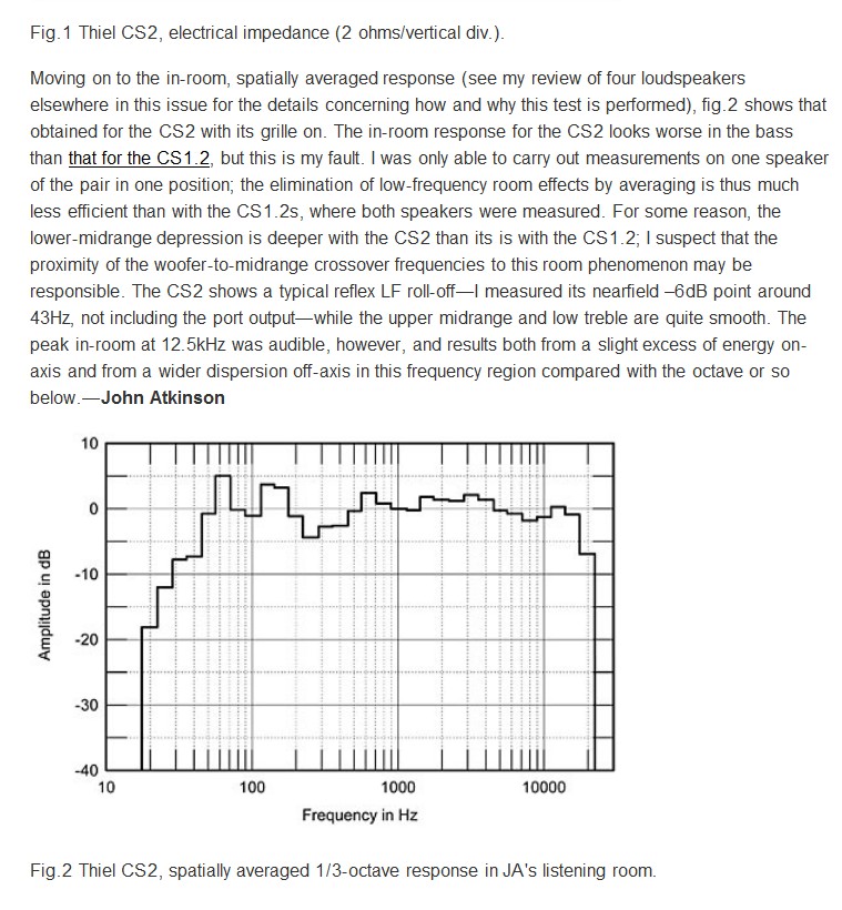

Thiel CS2 - Stereophile.com
Albeit good they don't show in the measured specs the excellent quality you would expect from printed.
(I would bye them for $399 or 900 eur, although! link1, link2, link3)
