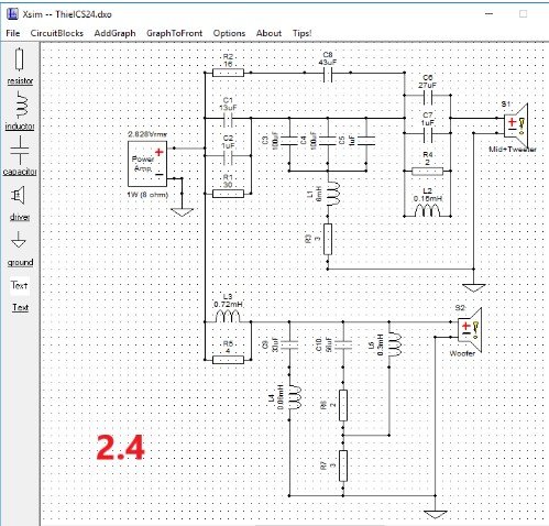

The 2.4 is readily available. But do you, by chance, have the CS 2.3 x-over schematic?
only find some pics

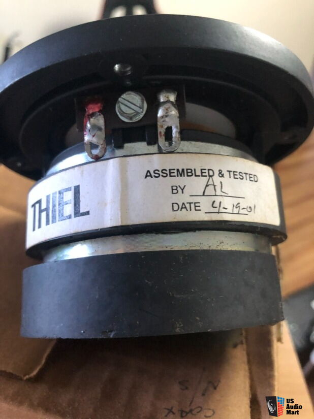

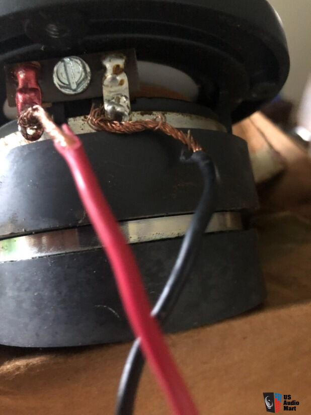

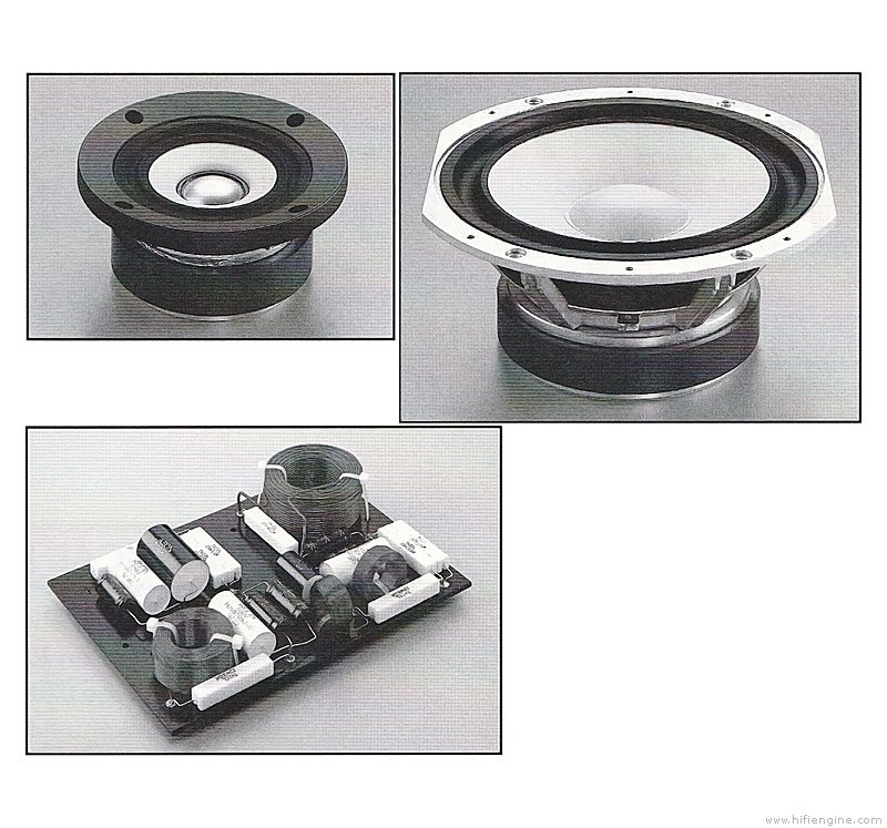

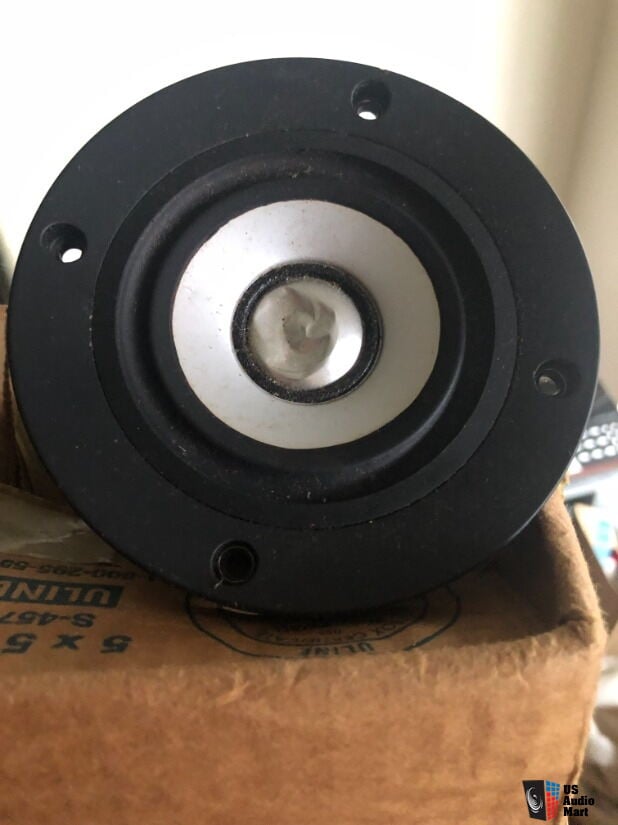

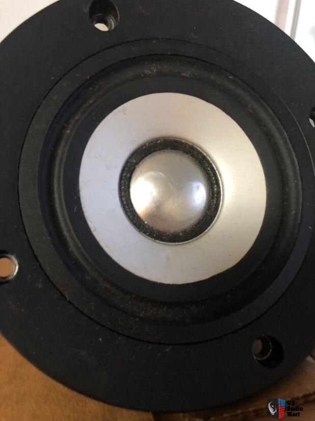

Yes, I believe it's a full range. Their so-called "mechanical crossover" is basically that ring of elastic material that allows the dustcap to decouple and behave like a tweeter. (Though it's not.)
The closest I can think of is the SB Acoustics full range, the aluminum one with the soft dustcap that mimics a tweeter.
If I properly interpret the cross-sectional sketch of the 4.5 unit, it is basically a full range with a dome like structure glued to the voiceoil former and a tweeter surround decoupled classic cone.
Alas, It did not lead to another revolution in wideband design.
