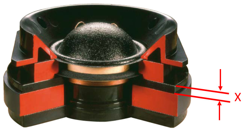

Can anyone help measure the thickness of the faceplate of the SM75-150S.
It’s the Super linear version of ATC’s 3” dome midrange.
I feel some machining coming on.
I measured mine: x = 8.0 mm (magnet top plate)

I have had some HiperCo50 bar offered to me and I'm toying with the idea of making the EMC for the back of the re-cones.
I have some none liner domes and there face plate is also 8mm so i am left questioning how they get a greater magnetic flux in the gap. I might have to split what i have and get a better understanding of the differences in coil.

Before you do anything, take a look at these photos.
The 8mm plate is part of the magnet system of the SM75-150. It is not part of the waveguide/dome/voice-coil assembly. So if you are planning to break the waveguide/dome/voice-coil assembly (="recone kit"), the 8mm magnet plate will most likely not suffer in any way. But you shouldn't need to break anything. After removeing the screws, the waveguide may stick to the 8mm plate (ATC tends to use glue in order to seal the system), but it should be possible to remove the waveguide without breaking things. Just use a small hammer and knock on the sides of the waveguide (put a piece of wood in between to avoid dents on the waveguide). If in doubt, get in touch with ATC, they have always been very helpful for me.

It is the magnet system that I am looking to build, hence the face plate size. The magnet itself is something I have never machined and will probably look to using Neodymium most likely in multiple block form. I'm still formulating how what and why.

I believe designing a motor / magnet system is a bit rocket science, and cloning the ATC design will not be trivial at all. Wouldn't you be better off to get in touch with ATC to get you drivers fixed with the right parts? I wouldn't be surprised if they would be happy to provide the magnet / motor system as a spare part.
