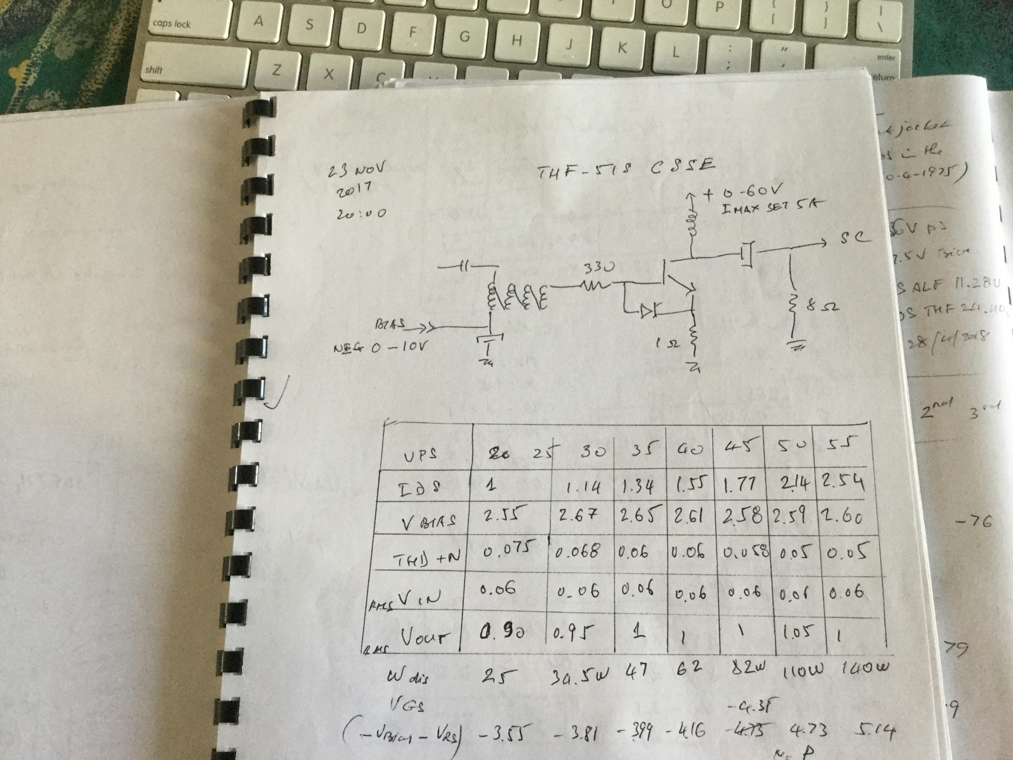

Hi guys,
I'm going to build a class A amp using THF-51S SIT since I can only find this instead of 2SK82, 2SK180 or 2SK182. THF-51S should behave similarly since they're the same class of device - SIT.
The final design is probably gonna look like this below but I have to experiment with the bias first before reaching the end point since OPT is going to be tailor made to the bias / standing current of final THF-51S bias point.
If anyone has tried THF-51S SIT with choke, CCS or even bulb loading, please share what the recommended bias is (load resistance, DC current, B+ voltage, and etc).
