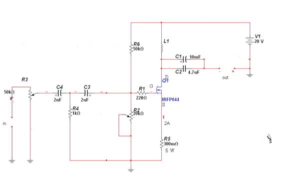

Hi ,Bogdan, very nice SE amp, can we get the parameters of inductor?
I have built a similar your amplifier ,the schematics
from forum,the voice like the tube sound,very good!
Best regards!
120mH / 0.9 Ohms

Yes, it sounds beautiful. I`ve made a change to bjt driver instead of mosfet, and switched to TPC. The sound is better. Amplifier is alive and well playing at my friends home .🙂

I'm building an inductively loaded SE amp too.
Inductor information:
100mH, 4A quiescent, 0.47R DCR, 1.5mm wire, 4Kg (8.8lbs), GOSS laminations, gapped around 5 thou. I had two custom built (around $USD175 each!) but yet to gap them with a good friends' gear in a couple of weeks.
If you use a CCS rather than an inductor the efficiency is almost halved. I'm expecting 54Vpp output from a 36Vdc supply, which into 8R is around 45W. From experiences with another SE amp I build in the nineties the sound will be utterly transparent; THD from LTSpice indicates it will be 0.002% at 45W, and the same at 1W. My design is much simpler than Bogdan's amp, but the output design will use 2 x FQA36P15 trenchfets from Fairchild. I have a stash of these devices which have a Pd of 280W. Front end will be tube. Thermal issues are paramount; I will be using a slow speed 120x120 fan blowing up into a tower of heatsinks. This is a love project, not a commercial product. I cannot imagine selling this with 300W heat and 2 x 45W output.

Yes Hugh, I think that your concept with "Glass harmony" amp - tube gain stage and cfp choke loaded follower should sound better and you don`t need the GNFB. The Pathos amp used that concept as well, but with plan source follower and IMO wrong type of tubes (12AX7) . What tube you plan to use?

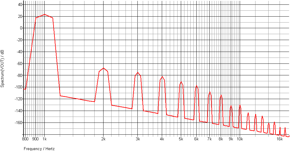

You betcha Wahab,
The predominating H2 with linear reduction of harmonics is the hallmark of the Class A SE.
But you knew that...... I have just received a box of magnetics and now I have to fix the pcb design. Keeping the beast is tricky; I will be using a 120x120 fan at 1500rpm and very narrow finned heatsinks.
The price to pay is the huge heat dissipation, and relatively low power output. THD is actually not very low.
Hugh

Hi Hugh,
Distorsion is really not a problem here since it s 0.01% at most at 1KHz and no more than 0.05% at 10KHz, much less the 60W (per channel) dissipation, but given the topology it can be fed with 18V and still be within HiFi specs power wise (DIN 45500 sort of...) with only 25-30W thermals..
Anyway have fun with your build, thoses designs are rather electromechanics than electronics, and somewhat of a tubish concept...

Hugh, I think it`s better to invest in a larger heatsinks and lover the voltage for fans to get a lower rpm. I already tried something like that, and I think you will hear the fans and air flow at this speed and rise the noise floor of your room at quiet nights. 🙂
Hi Borko,
Good advice.
However, I used a Conrad MF18, played a 120x120mm fan at 1500rpm through it, and dissipated 175W at an ambient rise of 27C. It was a heatwave in Melbourne at that time, and the day temperature was 42C at 5pm. The heatsink was at 67C, dropping to 52C during the night when the ambient dropped to 25C. I'm planning to drop 140W across each heatsink (two, facing fins with a fan below driving air through) and I realise the biggest noise will the turbulent as the rotating airflow passes to the fins. I will need to use a plenum, I think, to remove the proximity between fan and fins.
It should be OK, but I will let you know..... right or wrong!!
